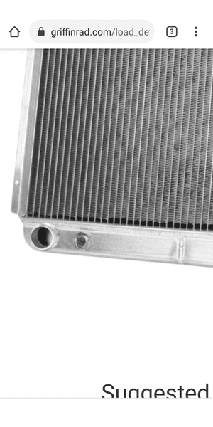

I can't believe that Griffin didn't pressure test this. Water poured in the top of the radiator doesn't even slow down on its way out of the AT cooler fittings.
You sure there is even a cooler in it? Poke a probe into the fittings and see if you can "feel that it goes straight into the tank. What kind of plugs were in it? Were they substantial plugs? Maybe it was supposed to be a "stick" radiator
The biggest question how overfilled was the transmission? Also does your torque converter have a drain if so pull the plug and see if water comes out.
If water comes out of torque converter that means the valve body and all of the passages are probably full of water also. If you have water coming out of the everything my opinion pull the trans out and go through it better safe than sorry.
That was my thought too. But I can't imagine how/why they would have attached bungs to the place where the cooler passes through the tank.

Ordered it as AT directly from Griffin and these bungs look pretty AT to me...

Just my two cents looks the trans cooler line is hooked to the drain and you have the drain hooked in trans cooler fitting. The welded bung is usually for the radiator drain. The brass looking ones are usually for trans cooler.
Yes it looks like you hooked up to the radiator drain line. The welded one goes to the petcock to drain the radiator, the two ports with what look like nuts are the trans cooler ports. This does not look like a Griffin mistake. Looks like operator error mistake.
Yep, transmission cooler lines hook to drain line. If any water got to the bands or clutches your transmission is toast.
Operator error is a constant around our shop... There is a petcock on the other side of the trans that I assumed was the drain. There are two 5/16 nipples side by side on the side where the trans cooler lines come out of the trans. That's what we used.
Yes indeed. You have a transmission line connected right to the bung where the pet **** for the radiator drain is supposed to go. The transmission line bungs are always on either side of the tank and never that close together.
That said, There's no way in this universe I'd trust that transmission now. No way no how. It come out and back down to get cleaned up. Think about what had to happen. You said water and transmission fluid came out of the dipstick tube. That transmission had to be SLAM FULL of water. It's done as it is. End of story.
