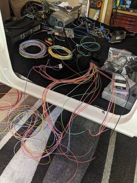

Back to your question. I would use and I have used just a generic speed master 20 circuit wiring kit. Maybe like a 150 bucks. Or forty percent off unblack friday...
I find the kits that try to use bolt connectors like the factory. Have just another place for things to go wrong... I prefer a true hot rod kit that Eliminates the bulkhead connector and runs directly to the connections like ford did...
It's basically a fuse box with all the wires. And what I did was cleaned and reused my end connections and bought the solder filled butt connectors and the heat gun.
From Amazon...
My favorite tool, what's a 10 AM power supply? Use as if it was the battery or even reverse hook it up. So I could make everything work before I had everything completely connected. That way you're not putting the full amprage of the battery and burning wires.

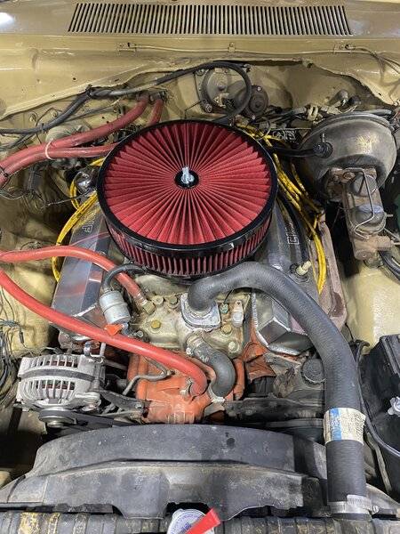

Post up some pictures of your engine bay and your Scamp!!! I’m partial to the 75’s too.
Before is with the chrome air cleaner
After is with the red air cleaner and fab valve covers

Looks like your Scamp had AC once upon a time too.
