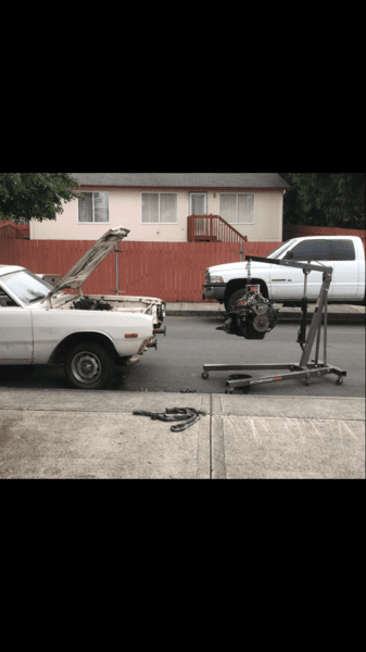

Good ol POS from HF did the trick pulling the 318/904 out of my Dart Hang 10. The adjustable engine hoist is a must to get the angles right with leaving the hood on..

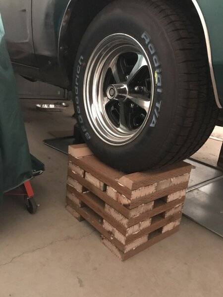

What's a crib?
Sorry, what I should have asked is what hoist are you guys using when you've got the car on pretty tall jack stands which would be similar to this crib method.

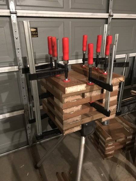

Those look great! Yea, I'm going to make a second pair out of wood. I just lucked out and found a set on craigslist as I was planning my lumber purchase. Are you pulling the engine in and out while on those cribs?

Price of lumber now days those would cost $100 each. (but let's not go there) :rofl::rofl:
