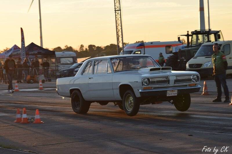

I run pretty much what you described as your old setup....minus the DA shocks and caltracs. I love it, absolutely streetable and ran 10.66 this last weekend. If i win the lottery, i´d build a SB from a R or Ritter block, big bore and big stroke (450+ inches maybe), with a set of indys and a relatively mild hydraulic roller cam around 255@ .050". Should run 10.0s without trouble, do some better wheelies and be streetable in my opinion. That would be fun :)
