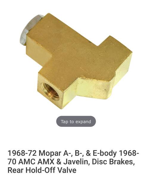

What is this brake part called?
70orangeswinger
Oct 25, 2008
344
21
northcentral PA
I can't locate one of these. Can anyone identify it and possibly tell me where I can get one? It's for a 1970 Dart Swinger 340. Thanks
You can rebuild them. Is it disc brake or drum? Makes a difference. A picture from the side would make it clear.
Distribution block/proportioning valve.
If it also has an electrical connector like my 1969 Dart had, that is the imbalance switch and unit is termed "combination valve". If front disks, it also has a "front metering valve". Need the correct variation.
Search carefully, plenty are listed for many specific applications, but are "generic"
