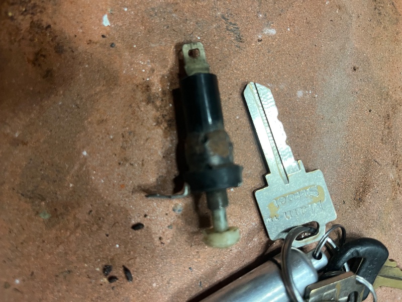

I was removing my clutch pedal override spring today and as it came off it apparently knocked this switch out. I found it in the floor. Can someone identify it? The key is for perspective on its size.
Yes, the metal clips on the switch are supposed to hold it in place.
The L bracket it goes into has a bolt that is accessible from the passenger side of the steering column for adjustment. DO NOT BEND the L bracket (unless it was previously bent, then bend it back to an L and adjust the bracket with the bolt)
