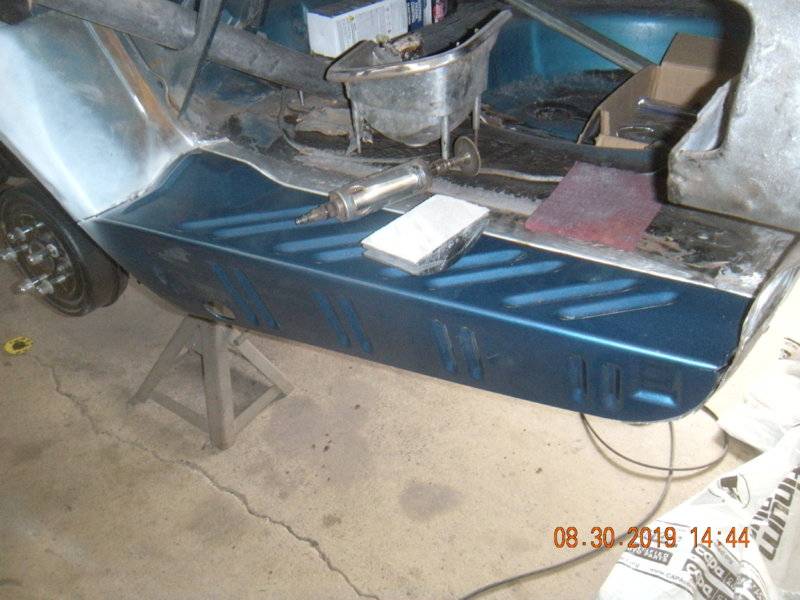

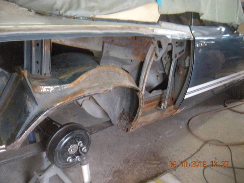

My Fish getting some love. New full AMd QTRs going on and AMD drop offs. The fit is great. The lip on the outer wheelhouse has ben repaired. My floors and trunk floor is rock solid on my 69 Barracuda Convertible.
AMD Full QTRs cut down to fit. U can only get from AMD the fastback Qtrs. To save some cash on shipping buy directly from your local AMD Dealer. The fit on the dropoffs and qtr's has been excellent.
