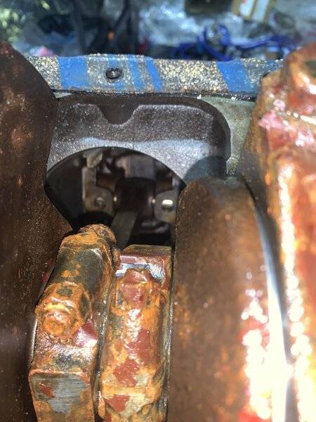

I’m half way through dissembling that rusted up 360.
Remember that one? After I take this apart (with little hope of an inexpensive solution) I’ll start digging out my 340 blocks that haven’t been sonic checked yet to see where I stand.

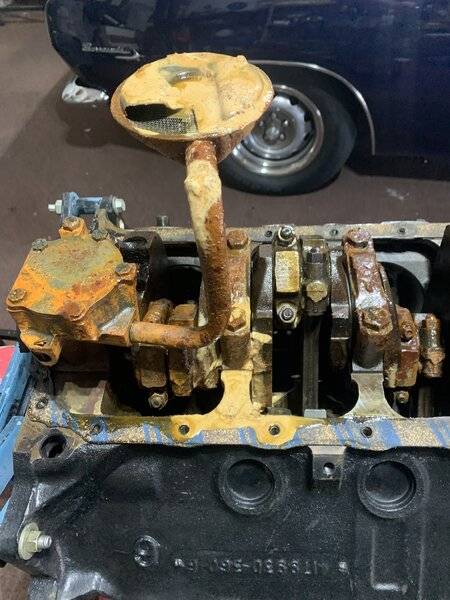

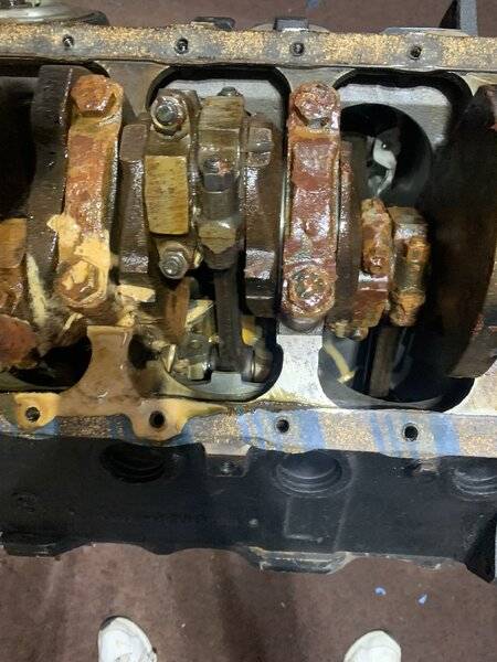

Couple days in a vinegar bath would do wonders for that thing.
@mgoblue9798
I’m NOT purchasing that much vinegar!
:rofl:
Though it’s probably cheaper than that solution you get at Horrible Freight. (I can’t think of the name right now of that rust converter that turns the metal black after use.)
The con rods I can see. Not the block. I’ll get some pictures later.
The best part of that black block is that it is a standard bore.

A wire wheel in a drill will clean those mains and rods up the block doesnt look too bad inside...alot of times the oil dries up on the cast iron and it looks like rust but its old dried oil with dust in it...
@Dartswinger70 Thanks for that. I agree. Last night I dug out a 360 block I prepped for storage. The front cam journal looked hammered until I got my glasses on and realized it was the WD-40 I soaked it down with prior to wrapping it up.
Lots of ways to skin a cat for sure. The main reason for the vinegar is it gets into the block coolant passages and breaks up the rust crud better than some other methods.
