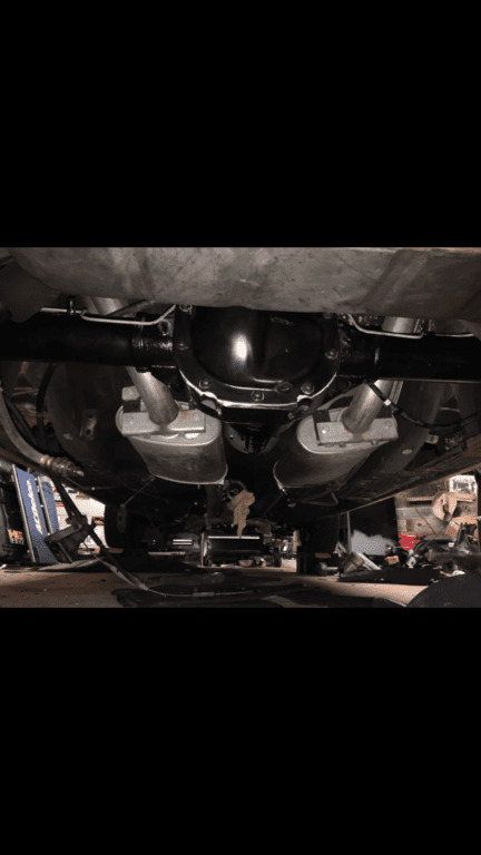

Post up some pics! Wondering what works and looks good on the shortened 8.8 ferd?

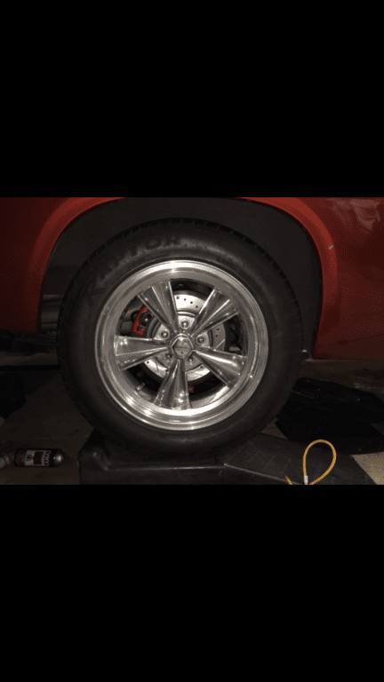

If you go 15 inch they probably will. All I know for sure right now Is 14 inch Cragar SS wheels will not fit. Over disc brakes that is. Maybe drums?
Nice work on your swap!
Thanks!! I have 15x8 on the back I believe. When I purchased the rims there was fatter tires on them and they wouldn’t fit without deflating the tires to get them on. I think I have a picture of the old tires. I will post it if I can find it.

Rainy, stock mopar steel wheels fit the 8.8 perfectly. I have mopar 15" cop rims on mine and they clear the disc brakes with loads of room. The hub pilot diameter is the same.

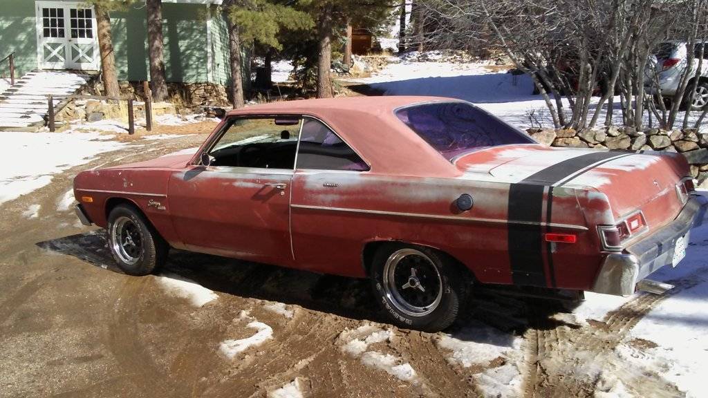

Josh your Dart looks great - Love the center caps!!!! What year is your car?
Thanks prican_2000 my Darts a 75 Swinger originally a slant 6, I dropped a 383 in it last year. If you shorten a 8.8 I believe all you do is use 2 short axle sides/Drivers sides? I believe in one unit. I had a buddy build mine from 2 cheap Ford Explorer 8.8s.

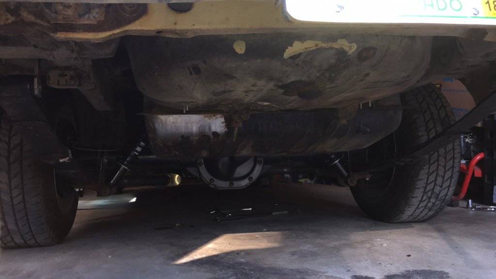

if you get one from a ranger it's already the right size for an A-body without having cut and paste anything.
mine is coming from a 95 ranger and as far as I can see, it's going fit in my valiant with issues

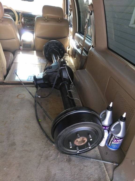

Yeah but a 95 ranger will be drum brakes though. a large part of the reason with going with the Explorer rear end is the Disc Brakes, Gears and LSD - all of which did NOT come in the ranger - right? what about the shock plates on the 95 ranger will they have to be cut and rewelded to the A-body specs, or is it really truly just plug n play into an A-body????

I have not done the swap as of yet but I was under the impression that I have to work the perches to fit in an a-body ....I overlooked that when I said you wont have to cut and paste anything because I was thinking of the axles and axle tubes when I said that.
the ranger rear does have drums but I am cool with that.

I’m not sure about the 95 ranger being a direct bolt on even with the perches moved to the A-body specs. But I do know you will have to shorten your drive shaft. I have drums on my 8.8 and haven’t had any problems yet. For a 100 more bucks I could have gotten disc brakes. Kinda wish I would have... just st to be able to say it’s got disc brakes on all four..lol
