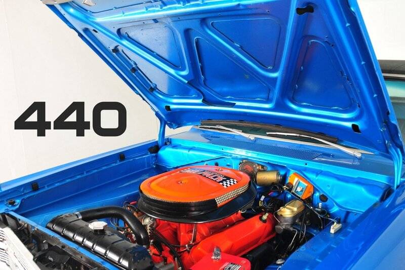

When I was originally building the 440 for my Scamp I wanted to go with a six-pack but skipped it thinking it that it was not able to fit under the stock hood without a scoop, but recently saw this photo of a dart that has it with no scoop. Has anyone else done this? If so is that part of the hood support the only thing that needs to be clearanced? Here is the photo of that car.
I believe many have done it without modding the hood. My '69 Barracuda didn't need it with a '67 or the '69 hood. Spacers under the cabs ain't gonna' happen unless you're cuttin' though.
DO NOT install the air cleaner hold down studs until you know your clearance!
Do notice the wiper motor in your picture. A two speed will require a notch in the air cleaner base. If you have a "shaker" base, all it needs is a small bend.
BTW, I recommend a torque strap.
i don't think they're any taller than any other stock intake/carb/air cleaner
Some use 1'' spacers between the K-Member and the frame for extra clearance.
I know the '68 Hemi Hurst cars did this, so you have to think about front end component geometry issues if you do this mod.............
Looking at that picture it looks like they did some cutting on the inner bracing on the passenger side, left side in the picture.

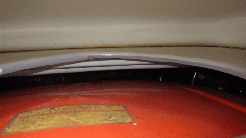

FWIW, Mine, inside the scoop looking toward firewall..........
Much tighter when looking forward passenger side...............
