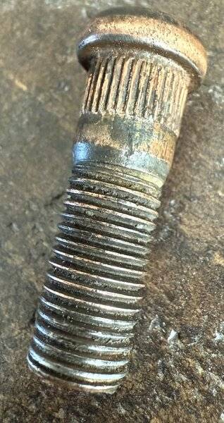

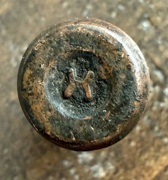

Hello FABO! I’m looking for some help identifying and finding a replacement for my wheel lug studs… 1965 Plymouth Barracuda 273/904 auto, 10” drums front and rear…

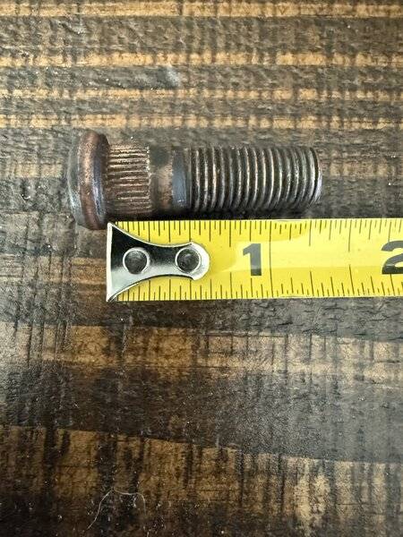

I’ve gone to NAPA and they don’t show an exact replacement and I’m not sure what this means for an exact replacement or other options…

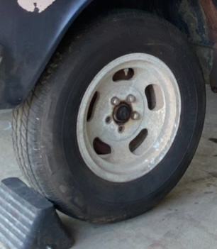

I’d like to refrain from any major changes, if possible, as I plan to use the same wheels that my dad had on the car… some of the lugs are stripped, broken or just flat out MIA… any and all feedback is greatly appreciated! Hope you’re all well! Happy wrenching! Thanks!
BTW if you have BBP vs SBP the studs will be 1/2" vs 7/16" and that indicates a swap of parts at some point.

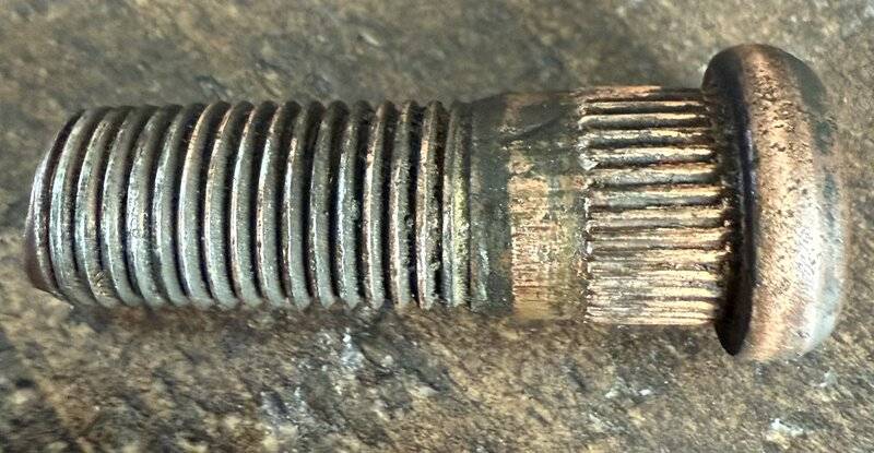

Are you replacing all or just one side. The left probably has left hand threads, no one makes them. If you look on the end of your studs you may see a "L" or a "R" on the outward facing ends.
If you are replacing all of them then converting to all right hand is a good decision. BE SURE to press in vs pull in the studs. it's more work but no chance of over tightening the lug studs and causing potential failure.
Napa's online catalog sucks.

I did not see an L or an R but I will check for that… being that some are missing and damaged, starting fresh seems smart at this time…

Of the two you have selected (is that rock auto?) is it going to be by length of the entire stud or shank?
Also, will converting these to right hand or a different stud present any issues with finding the correct lug nuts that will work with my wheels?

Get right handed lug nuts for the same studs you buy. Your old left side studs would have been copper in color with a letter L stamped in the threaded side end ? The right should be black or natural color with an R stamped in the end.
I just looked at the application I did not look at the specs
It will make it easier. Very hard to find LH lug nuts except standard tapered ones

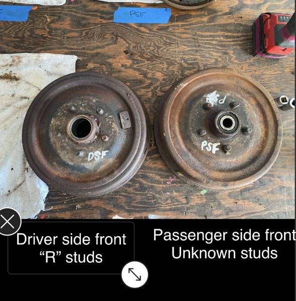

You’re onto something… I found a few pictures from when I took them apart and I do see R on the driver side studs… but no L on the passenger side… also a little different drum style from driver and passenger side…
(Also, unrelated but in the same are… two drums had the “vibration” spring wrapped around the drum… are those critical to have or unnecessary?)
Try a nut on the right side and if it goes on the left side as well, they have all been replaced.
It's not surprising that the external design of the drums is different in 50+ years.
As long as the critical dimensions are correct, it's of little concern.

I’ve got “R” on the driver side front, passenger side rear, NOTHING on the studs on the passenger side front or driver side rear…
Its not surprising. a lot of years things can happen.
My guess is at some point the LH studs were replaced with aftermarket RH studs, ("no marking on the drivers side rear") aftermarket studs typically do not have the R since it is implied that all studs are right hand and the front drivers side was changed too but the PO put the OEM hub\drum on the drivers side. with all right hand studs they are interchangeable.
It actually makes sense.

The pass side had the no R on the end right,?
That correlates well with the studs being replaced in the past

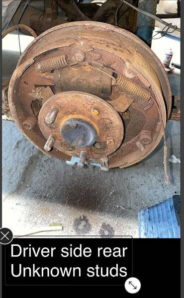

So after a little further digging, I found a box of parts that I had not previously gone through thoroughly from when I first cleaned out the car year ago and found one more stud and a lug nuts with broken studs inside of the nut… so at this point, I am only missing the five studs on the driver side rear hub… which appear to be the copper colored ones… I’ll run a nut into the threads to determine right or left thread and get back to you …

Driver side front: right hand thread (have 5)
Driver side rear: left hand thread (have 1)
Pass side front: left hand thread (have 5)
Pass side rear: right hand thread (have 5)
So, I either replace/ convert all of them to right hand thread and new nuts as well
or just the 5 missing from the driver side rear… (this would be a little friendlier on the budget and also not involve removing already installed lug studs on the remaining hubs… just 5 studs and 20 nuts… but as you mentioned left hand is hard to find…
So...
If you swap the front hubs.
You will have
Driver side front: left hand thread (have 5)
Pass side front: Right hand thread (have 5)
So all you will need is 4 LH rear studs.
