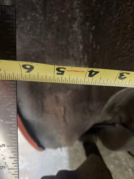

Ok so measured the rear to figure out backspacing. Looks like I have 6” from the inner fender to the outside lip of the hub.
I have 5 1/4” from the lip of the hub to the inner lip of the rear fender.
My 14” Rallye wheel has 3” of backspacing and 2 1/2” front spacing.
Do these numbers seem correct?
