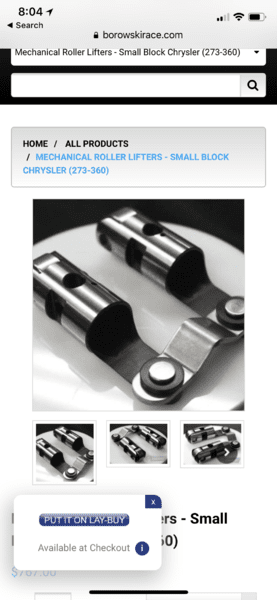

                    oil pump is m72hv rod clearance .0025 mains .003
                    Here is the lifters come just one small hole to oil the bearing. BAm 3 holes
