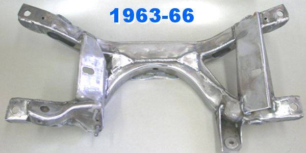

To increase strength, Have the entire perimeter of the "K" member welded. It is 50 + years old.
He's got an early A body. There isn't a defined perimeter that can be welded on the early-A k-members as there is with a 67+ version.

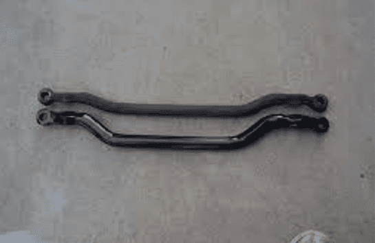

You will also need a V8 center link for the steering.

They’re not. They don’t have a perimeter seam like the later K’s but there are plenty of seams that can be welded and reinforced
From Firm Feel’s website

Nope. All of the center links are the same for the early A's. Let's try not to confuse this guy more than he likely already is.

The A body was originally designed for the slant six so there actually are 2 types of center links. The shallow offset one is the slant six version. The deeper offset works on both slant six and V8 models.
Sorry, Evan....
You're right! Sorry for the confusion. Not sure why I had a brain fart on that one. Here's a photo I took many years ago. I was actually able to use the slant 6 centerlink on a V8 '66 Barracuda I had a while back. Rumor has it that some factory slant cars came with the V8 centerlinks from the factory too. Go figure!

I go over all of the factory welds, weld all of the seams (the entire perimeter on the 67+ K’s), and gusset the steering box mount and LCA pin tubes. I also install a skid plate on the bottom to further gusset the K frame as a whole.
I'll have to look again, but I don't remember the K-member under the slant six looking as beefy as the one in your photo. Yours seems more boxed in where I was thinking mine was more angled steel with less enclosed "boxy" areas.
Its not my K member in the picture, it’s from Firm Feel’s website and it has been reinforced. So some of the open areas have been gusseted.
