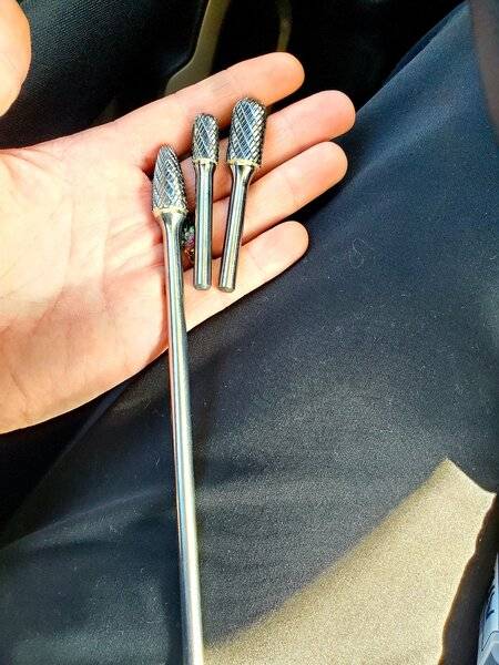

I just got my burrs from Mcfaddendales (dang they were more than the grinder from Harbor Freight). So ill start messing around when I have time, school just started back up so most of my practice will get done on the weekend... hopefully I can get some good practicing in and get a little faster before taking my dart apart to port the x heads.
You will soon find out why it's so expensive to port heads. Can we say "LABOR INTENSIVE & PATIENCE REQUIRED" LMAO

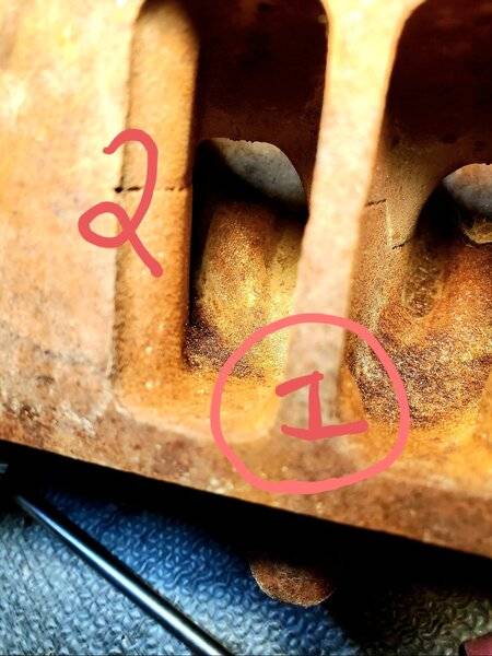

I agree, grinding for hours sucks ***... I just did a little grinding on these old heads for like 20 minutes while the wife was in the shower.
There is a big hump here, I took it out. Then this big hump, I assume has to come down too. Ill try and get my die grinder tomorrow on the way home from school.
I always take that bolt boss for the valve cover bolt out. I hate that thing, but I’m weird. If you don’t care about the castings and you don’t have a sonic tester, don’t be afraid to drill holes in places to see how think the casting is. And don’t be afraid to grind through in places to see what it feels and looks like when you do it.

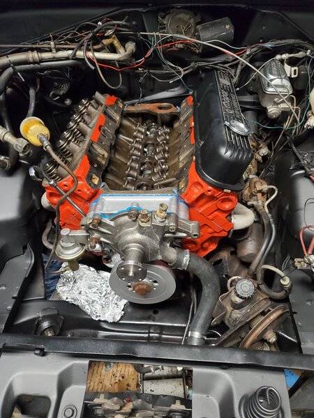

Doc just curious, why did you take heads the off?
^^^ DD, that's what we have been trying to explain. LOL
I know what everyone is trying to explain lol. I also think everyone thinks I'm going to go all crazy trying to be a professional porter... which I'm not. All the videos I've watched and threads I've read mainly say to clean up the imperfections in casting and help air flow more efficiently. I know I'm not going to get 300 flow #'s, but this gives me something to do on my car that doesn't cost anything really but time.
What heads? My xheads are still on my running car... right under that box... the heads I'm practicing on were one man's trash and my treasure. Lol. They are all old 70s 360 heads with 1.88/1.60 valves.
