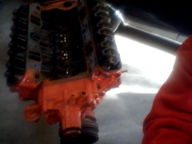

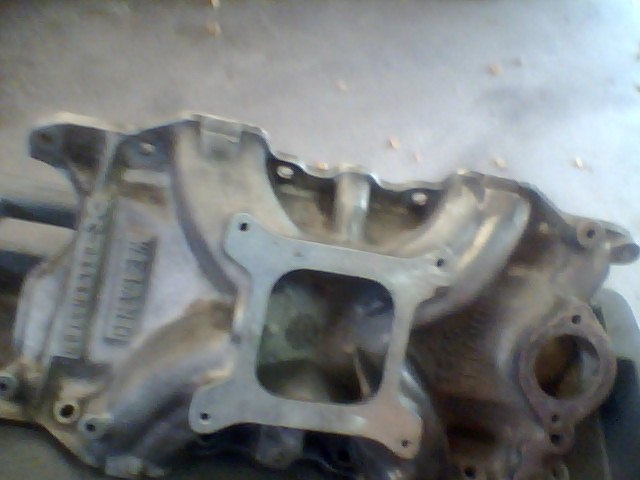

i have stock pistons and rings came outa my 71 360and brand new arp bolts to fasten them there 4.000 or if you wait i have some used 4.040s comming they are on my sir rods when i have them changed i would have rods and pistons for your 340 now you only need a cast crank we aint makin no 500 hp engine here and those x heads have a place to be and go 1 up i have a set of 273 heads off a running motor 340 torker intake and 650 or 750 dp holly"s we need to talk my man find a little duster, dart , scamp, i got a tranny with converter pick up some cheapass headers
i got an old eletric dizzy no box call me lets deal hell i got an old cam and lifters extra set of rockers on shafts pm me hell i got an early a radiator old starter i got parts u got parts we need a solid body phuk paint
we"ll finger paint it im me i"ll shoot you my # call me lets make some smoke
