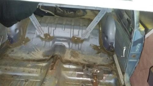

I found this car here (Valiantsurf) when I was looking for a set of fenders for my Signet. He was going to part it out so we swapped emails back and forth with pics and the fenders were NOS quality so I asked what the rest of the car looked like and he said rust free and straight so being the Valiant guy that I am bought it to keep it from being cut up for parts. It's a 67 Valiant 100 /6,auto,radio delete,manual mirrors with a/c and that was the only option it was ordered with and it is #81 off the assy line. He was going to make a drag car out of it with a BB and had already welded in the inboard spring kit into the frames and 1 frame tie in. It is pretty much a clean bare shell with no interior. I scored an a body dana 60 off CL,some springs, hangers at the Indy swap and I located a manual steering box and column. I have quite a stock of nice 67 grills,tail lights and other exterior chrome. I also picked up a 318/904 drivetrain from another member with some nice LA decor stuff and acc's I will need if I go small block.
I am thinking early 90's LA roller 360 block (need to locate core) with an A999 trans and the Dana with the top end TBD, I picked this one up because I can mod it how I want which I can't do to my Signet. I like the balance of a small block car and don't really want a nose heavy car and there is a butt load of aftermarket parts for LA motors still. I just got some pics from Surf telling me that the car is rolling and about ready for transport from CA to Chicago. I have no clue how quick this project will go since I am still working on the Signet's body so I will update as I go along. If I can get my Signet painted before this one comes home I will have this one in my garage at the house (1 car) and the Signet at my storage garage since it actually runs. I saw a fellow members' 67 Valiant that was painted satin black and I like it. It looks like a night stalker with minimal trim or I may go some sort of blue.

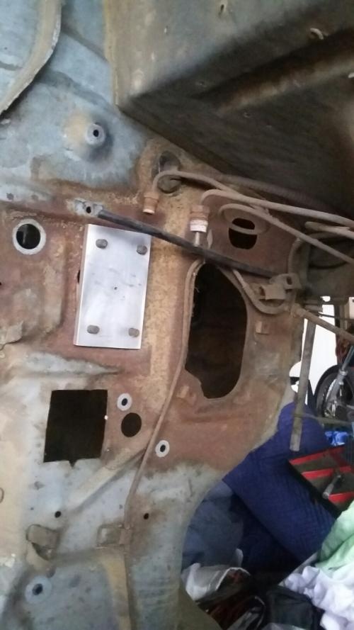

This car came from CA on casters and It's kind of nice having a parts car in the driveway to rob everything from. I robbed the front suspension from it,added the 73-up k frame,v8 bars,rolling rear axle,a/c box assy,battery tray,horns,front grille set up,gas pedal,DS door hinges so the door opens,wiper motor,switched out the splash shield,added manual box,column,tons of misc bolts/screws/nuts that were missing. The parts came from this green 67 Signet that I still need to finish cutting up.It don't look like that no mo either :P
It will be able to roll around soon so I can take it to my other garage to make room for my Signet that is at the body shop
I'm pretty much just assembling this car back to stock form with all factory missing parts and putting it in storage while I enjoy my other Valiant.
