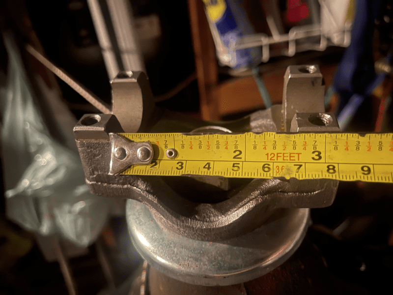

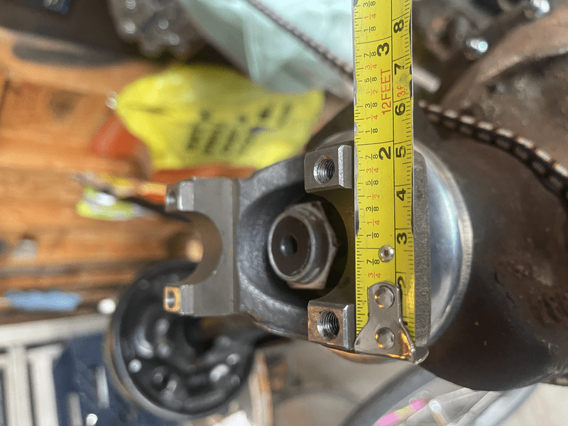

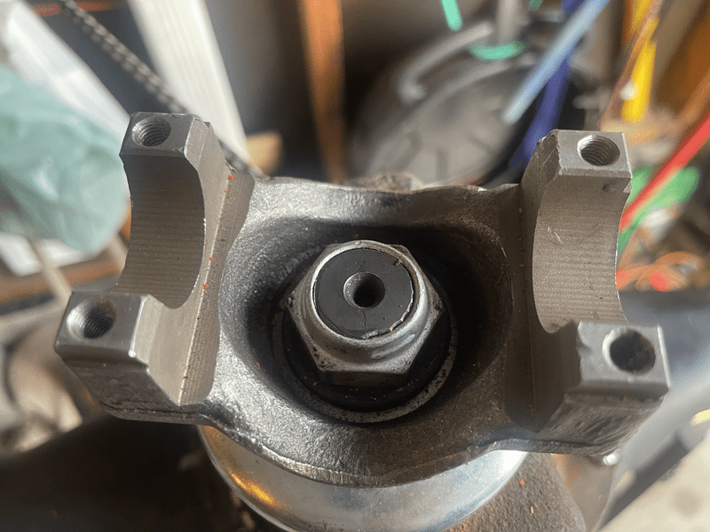

I have a 489 case with a 29 spline yoke but have no straps. Can you help me with the identification?

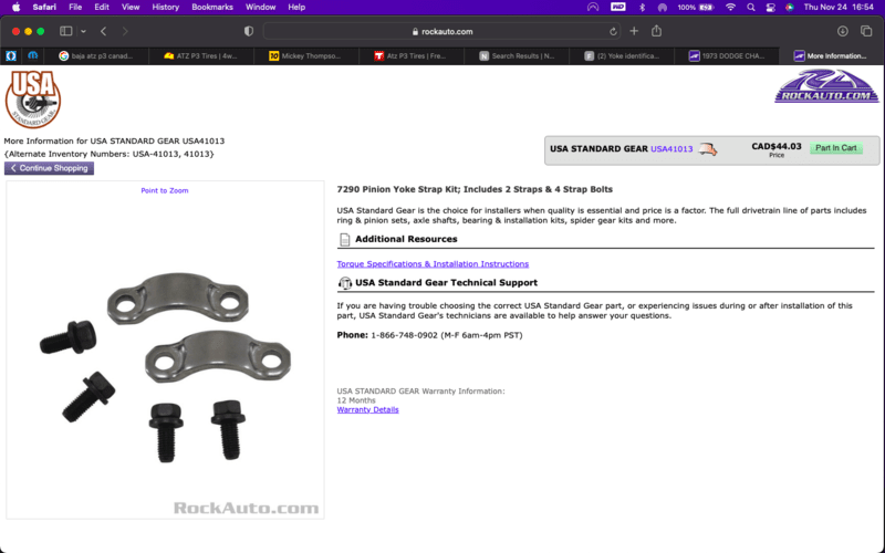

I'm leaning towards large yoke 7290. can some one confirm with the photos.

Yoke
bolt hole to bolt hole
Perch to perch
Perch to perch
If you measure across the widest part of the yoke, inside of the ears, it will
either be 2 1/8" or 2 5/8" being the larger size a 7290 yoke. Hope this helps.
