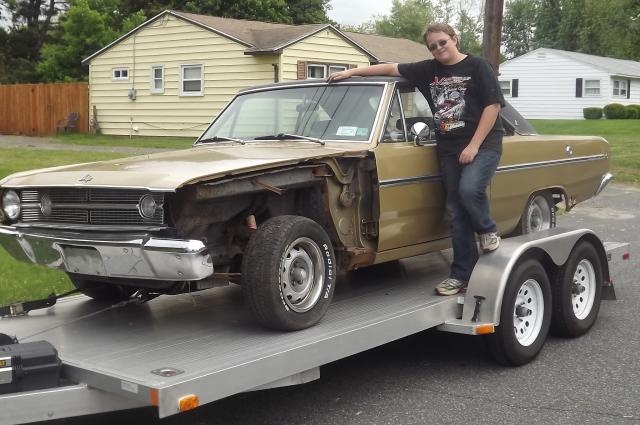

Hi,Im 12 years old. I just bought a 1968 dodge dart with my own money and I think i personally got a good deal. Its a 6cyl auto. on the drivers side it will need either a full quarter or a half quarter. The odometer says 8,162 miles ,does anybody know if it turned over or how In can tell? Thanks, The car has been sitting for 24 years and it is a one owner car. org. paint. This is going to be a project over a four year time span until I can drive. (the first few pics are at the members house(80fbody) with me picking it up,theres one of me with the car. The car is getting pp1 red paint with black top and black int. buckets,with a four speed or a auto 360 with a 8 3/4. does anybody have any interest in the rallies or the 270 trim? Thanks ,heres some pics

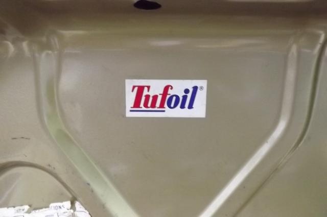

if i were you i would scrape that Trooper sticker off. nice 68! i think you can get lower quarters as long as there is no other rust and damage.
