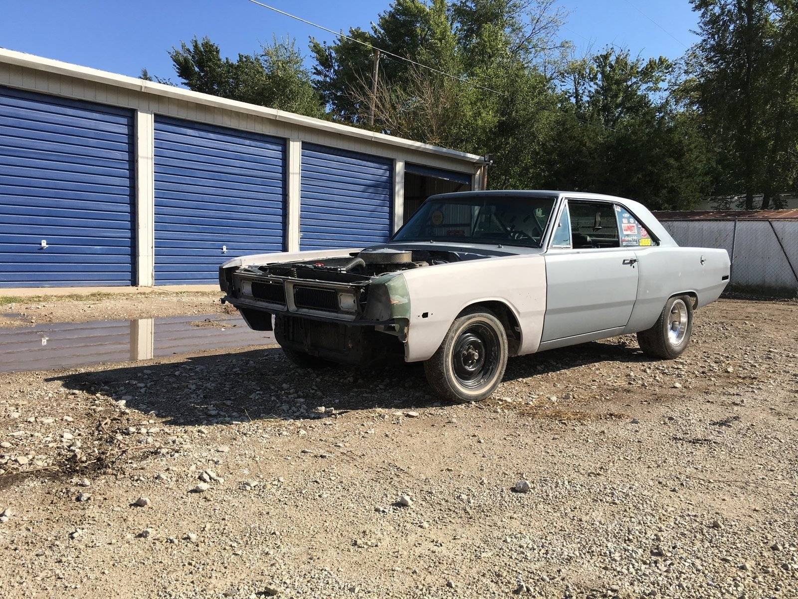

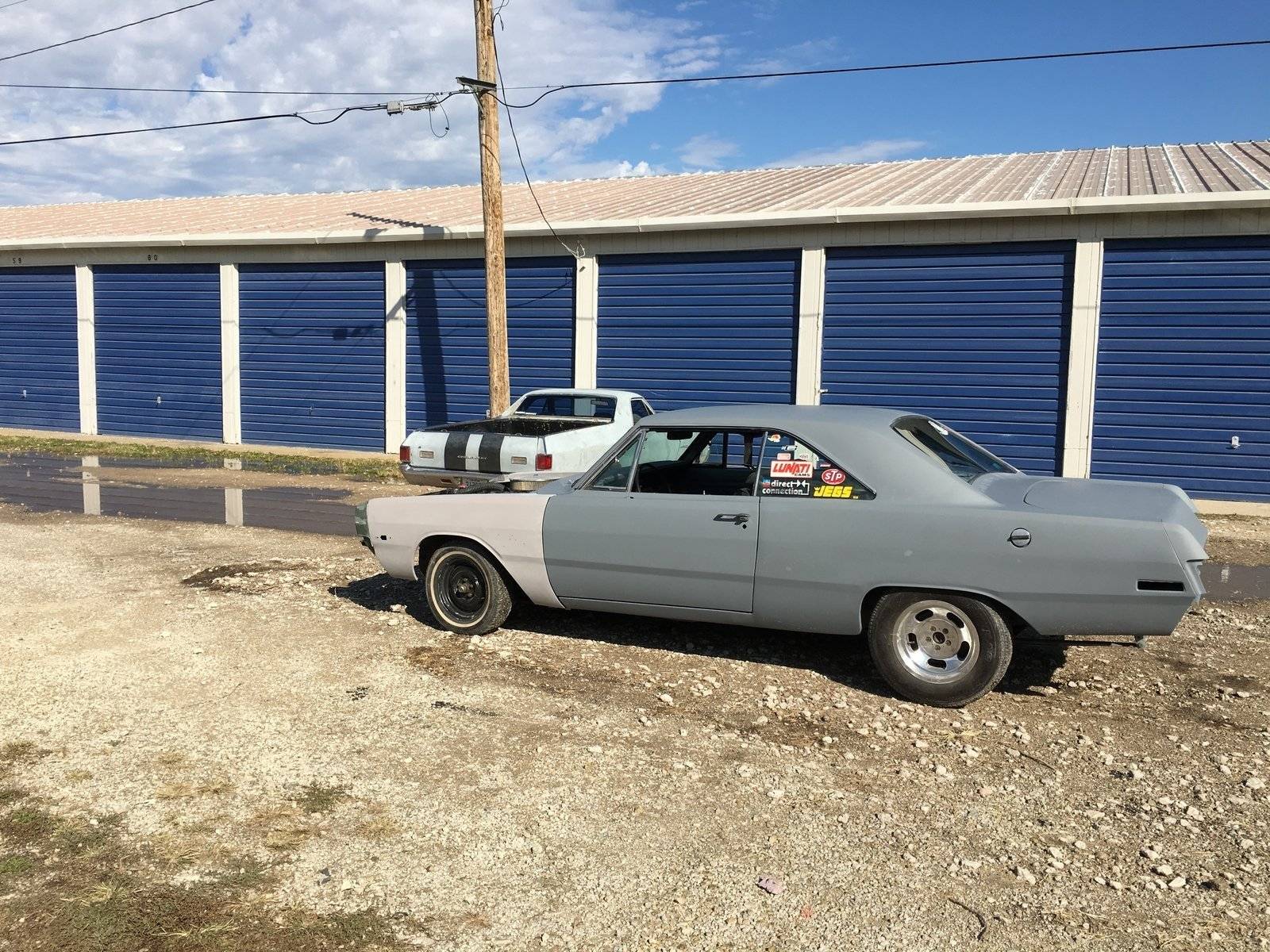

So I've got a good bit done on the car lately, and its going in the paint booth up here at my college this weekend! Got it blocked and spot putty on so I'm getting excited, weird to think that after five years of it apart ill be putting it together!
Been taking it for laps around and I'm itching to have it on the road. Not to mention how everyone I know has a badass daily lol
Got the body done now getting ready for the front end in the next couple weeks
Very happy with how it came out
