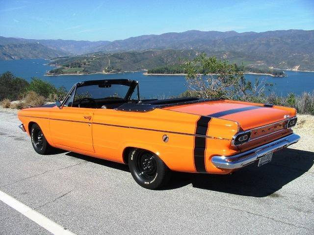

Here is a pic of a 235/60-14 on my 65 Dart,with factory 5.5" steelies.

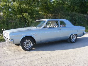

I actually run a 205/70-14 on my 65. The 235's I showed you are actually off my 70 V8 Dart.I tried them on the 65, just to see what they looked like.They actually seemed to fit pretty good.Maybe a 225/60 front and 235/60 back would be a cool combo.
The 65 is a slant 6 car,and the bigger tires actually dogged the slant pretty good.Thats why I run a 205/70-14 on it. Here is a pic with the 205/70-14.
