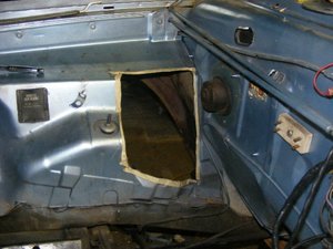

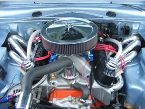

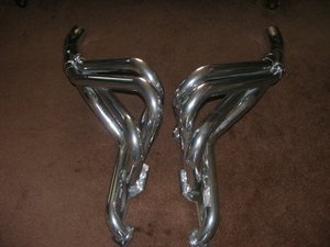

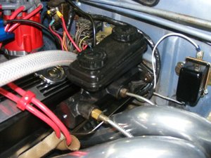

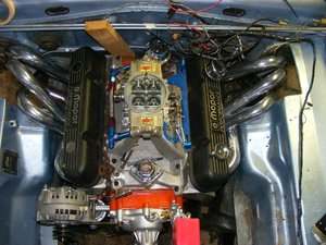

Sorry to hear your header whoa.I have the Heddman Huslers in my 66 Dart(weren,t cheap coated)I ordered through Summit and they took 3 weeks to make and deliver.Get ready to cut and fit.Here,s some pics of my job..
I mounted the twin master cyl. on the top 2 posts and customised an adjustable push rod for brakes.Have any questions,just ask.Good luck!

i had full fender wells years ago in a 66 with an iron dual master,,it never interfered but a suggestion,,ide reroute that brake line you have running between the header tubes,,massive heat will make that fluid break down and fail,,
Thanks for the pics. I'm going to run that same master cylinder and heat shield, and it helps to see that. I was going to use one of those new Speedway proportioning valve/brake light switch combos but it looks like it might not fit unless it's mounted higher.
Any shots of where the collectors exit? The main problem with the Hookers were that they interfered with the back part of the springs. If they were true fenderwells I think they might have worked.
