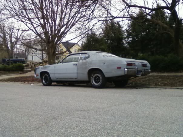

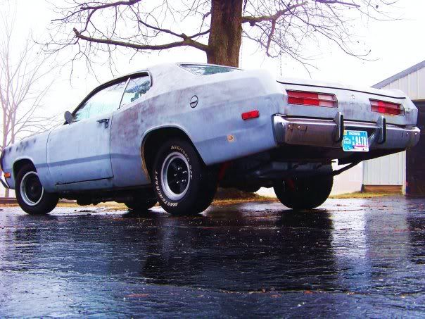

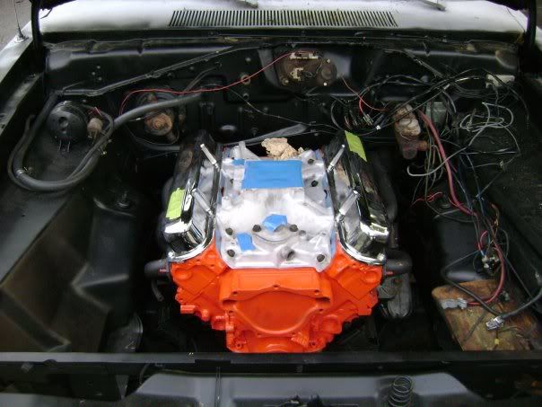

4 years ago when i was 17, i purchased my second duster. its was a 72 slant 6 car. drove it 2 years with it bone stock. the slant 6 burned so much oil i poured a half gallon of used oil in every 2 days. i had been working at cale kerms speed shop for sometime. i built my 360 after hours, the engine came out of a wrecked 77 dodge van with 70,000 orig mi. it a stock bore 360 with a hefty erson cam, stock heads with a severe port job, valve job, and heavier springs, edelbrock torker intake, and a holly 600. the engine was $150, the intake $15, the carb i traded a schwinn bike frame, all accesories were $5. its also got flowtech headers. the trans is a 727 out of a 73 rallye challenger, i rebuilt it and added a b&m shift kit. and used a mancini kit. the trans was free from a friend.
the rear came out of a 73 duster. its an 8 1/4 with an auburn locker and 3:55s. the rear axle was $40, gears $30, locker was $500. rear leaf springs are from mopar and they are super stock springs. i have disc brakes for the front that came from a 76 volare. free.
the interior is rough, no carpet. the floors are solid since the car came from az. car has no bondo at all in it. seats are from a 97 sunfire. free. and it has a new dashpad and of course, a foot print gaspedal. i also have a hurst v-matic floorshift. $20. im all about doing things on a budget. this car isnt a show car and never will be. i built it to drive. i did all the work. my friends helped paint the car in my driveway. dont worry, its only temporary. itll get a real paintjob after school. including what i paid for the car, i only have about 4 grand in it. and it is extremely solid.
