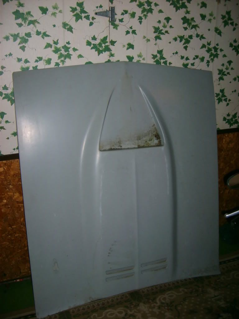

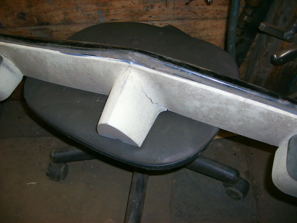

already have the fiberglass aar hood installed, also have fiberglass bumpers going on tonight or tomorrow. ill take some pics..

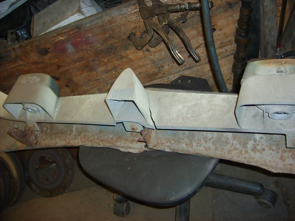

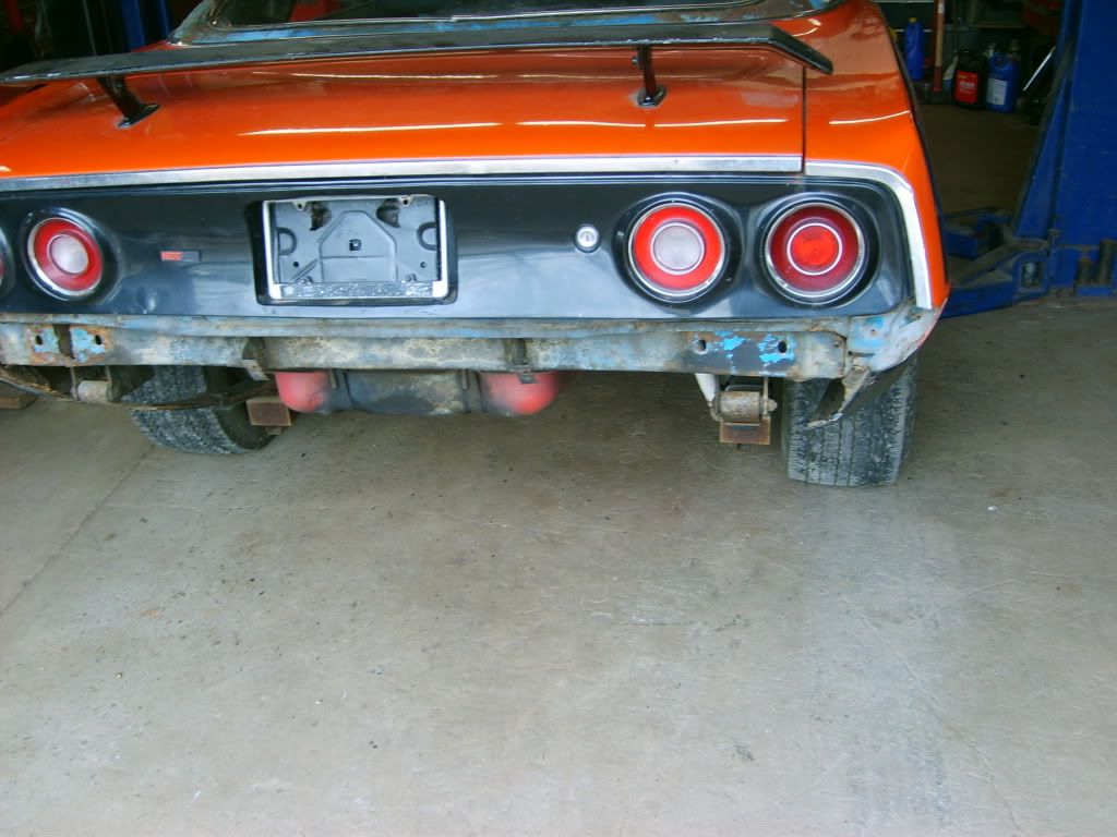

here is pics off fiberglass hood on, car with bumpers off, and pic of back bumper i'm gonna put on probably tonight. hopefully have the gas tank, fuel lines, rear sway and shocks off as well.
also through my searching over the car i see it needs a trunk, rear 1/4s and the back frame rails are a bit rusty. I like nice clean solid stuff. So I think i am gonna put to full rear rails in. rather do it now why its all apart rather then have them go bad 2 or 3 years down the road when its car is all done. Plus i know i can do it because i just put rear rails and a trunk in a customers 70 charger and come out nice.

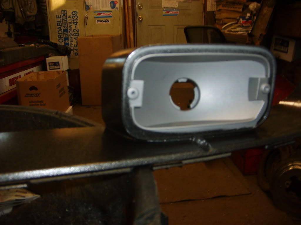

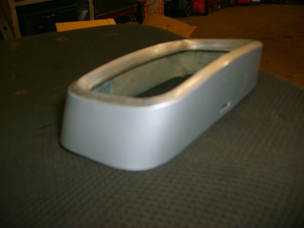

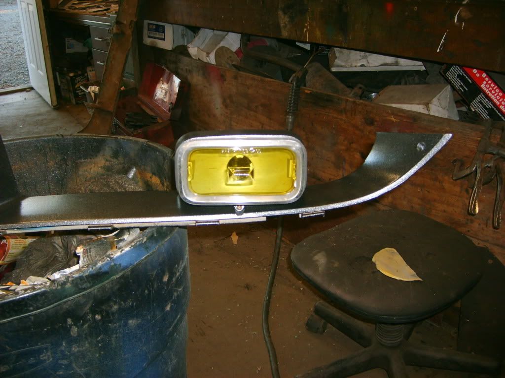

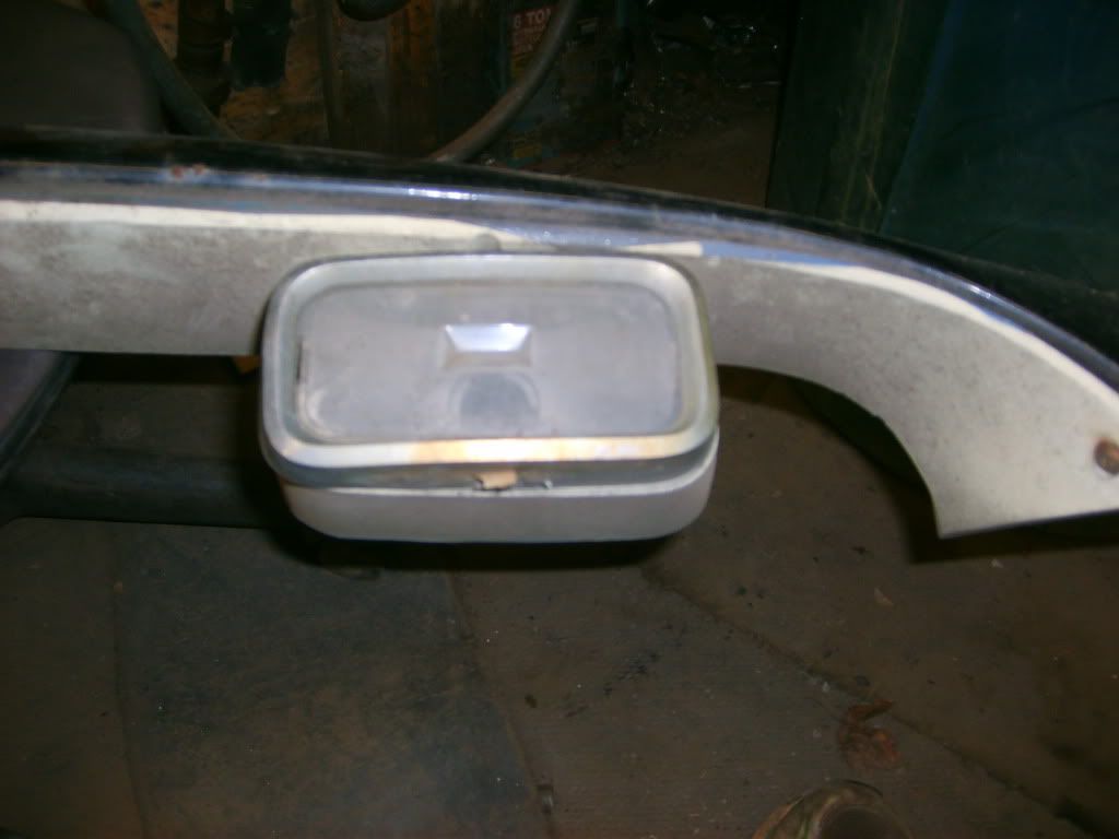

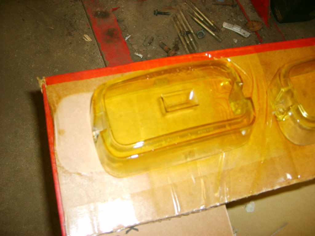

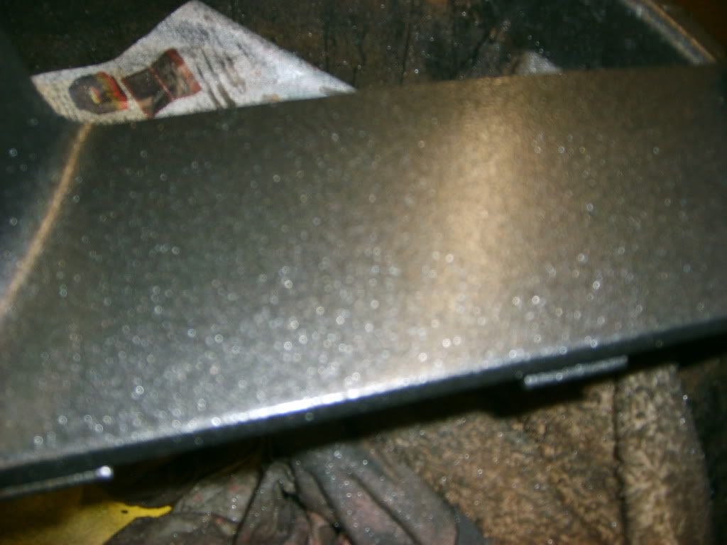

it was a blue car from the factory, here is some work i did today after work, i redid the front valence inlay
started with a broke one... i used castblast alumi blast and some grey textured paint i had and stained glass tint heres the pics
cheaper then buying a new one as i planned

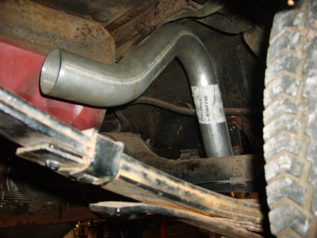

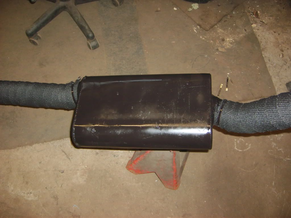

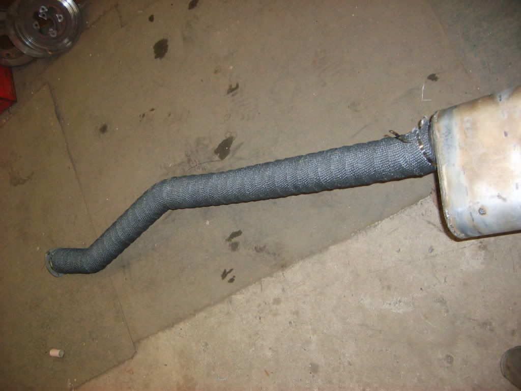

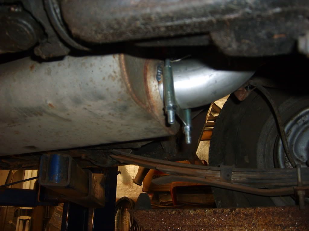

almost got my 3 inch exhaust done.. not so simple

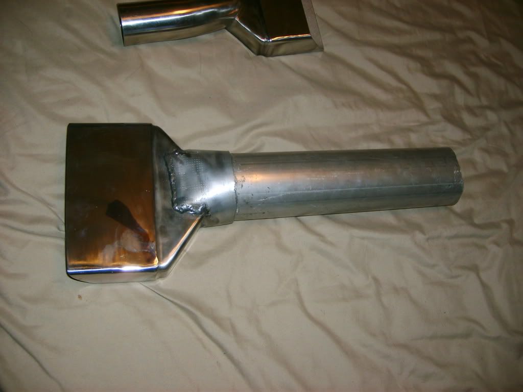

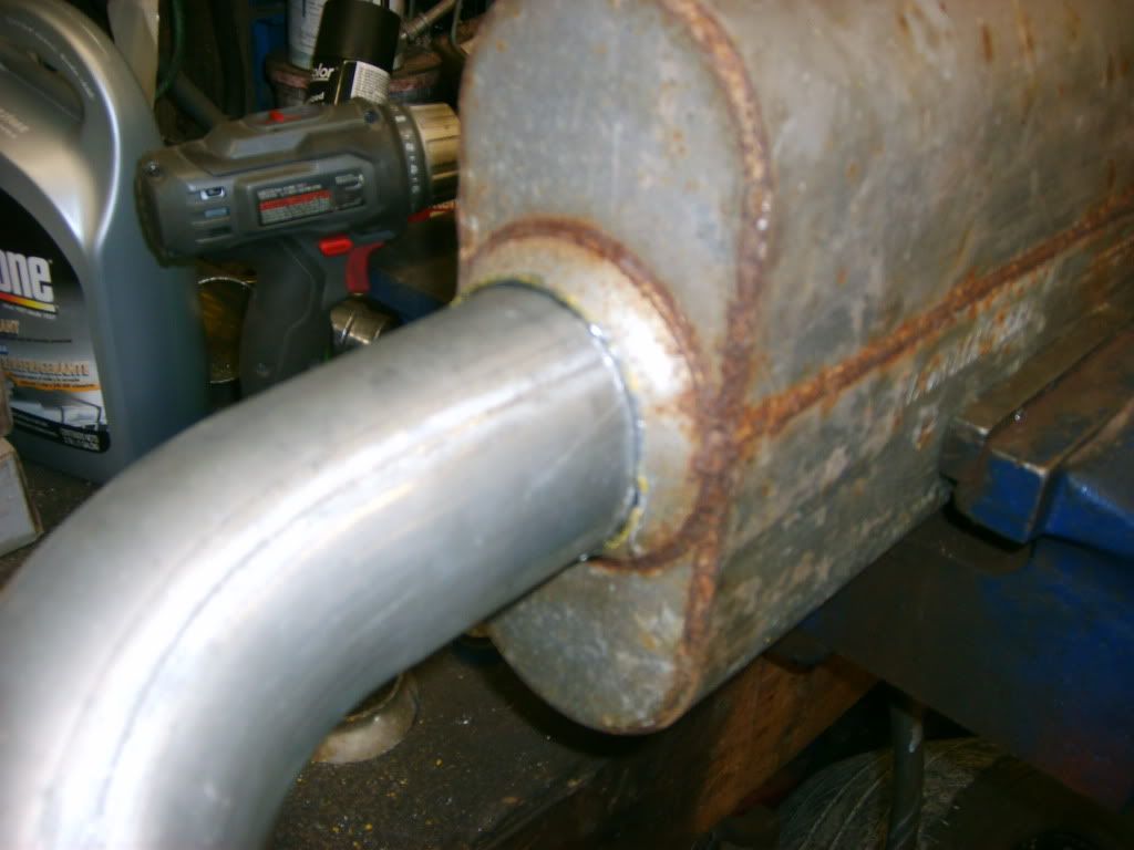

the mufflers were only 2/1/4 i had going in so cut ends off to 3inch would fit in... they were 50 series way to quiet so i ended up cutting one end of the muffler off and gutting everything in muffle half way back... i had cuda exhaust tips for years and smaller then 2 inch pipe going in.. there stainless so i cut them up and got 3inch to work doing to them... they need some more work... here some pics.. ill put pics up when exhaust i complete. I think i'm gonna wrap the exhaust all the way to keep heat off the floor
it sounds way good and tail pipes weren't done yet.. my brother and dad were believer of 3 inch plus my hacked up flowmasters haha
before and really nice but restricive
after and not done yet.. have to take air dremel and clean inside up alot more

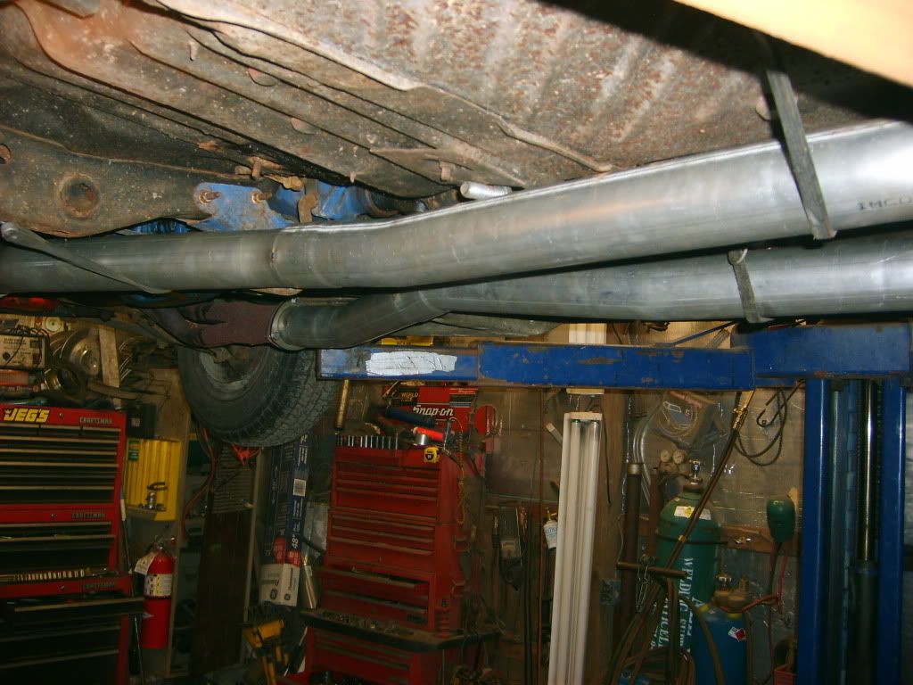

rest of exhaust in steps

wrapped front pipe
my flowmaster i cut open and changed
in the car

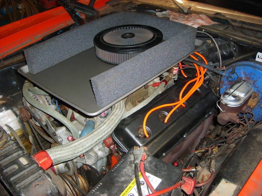

engine
