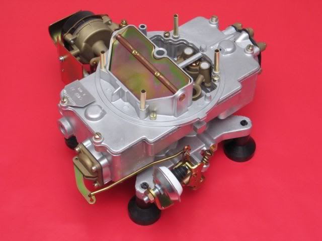

Looks like a reworked Autolite.
from all the reviews I have read it is a new take on the old autolite/holley ( 4110 or 4111 i think it was?)
but with many new school updated revisions and adjustability.
from what I gather its a one piece design so you don't have to worry about leaking gaskets here there and everywhere.
and I also gather that holley replacement parts work in it (outside of the replacement parts summit offers).
it also looks like it has a quick change set up for the vacuum secondaries. float sights , comes with a few extra tuning parts I think.
light weight design, suppose to be good to go out of the box,nice clean appearence and at a nice price compared to others.
one review of it that I seen, the guy said that with the summit carb he was running about 20 HP less on the dyno than he was with his previous setup.....HOWEVER he admitted that he did not tune it in or try swapping in different parts to match it up to his engine.

it really just a holley 4010.when my 340 was still a single 4bbl that was the carb i used for a long time.one of the things i liked about it was the annular boosters.it wrapped really fast and throttle response was sharp.
