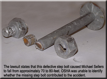

The first bad act is hooking this "gorilla hook" onto a climbing peg. Notice that these are welded, and DO corrode, crack, and break, sometimes from stuff like lightning strikes. So climbing these types of pegs "unhooked" means that IF one breaks you may die. There was a death involving a man climbing a Rohn self supporting tower, which come with a "default" ladder of carriage bolts up the outside of one leg. They are a pain in the ***. One of them was either defective or over--tightened, and broke off (they found it) and down he went---dead
The other and more obvious problem is the hook can come right off that peg
An aside---here is the tower death to which I referred:
http://www.wirelessestimator.com/t_content.cfm?pagename=Tower Climber Lawsuit
and the broken climbing peg
