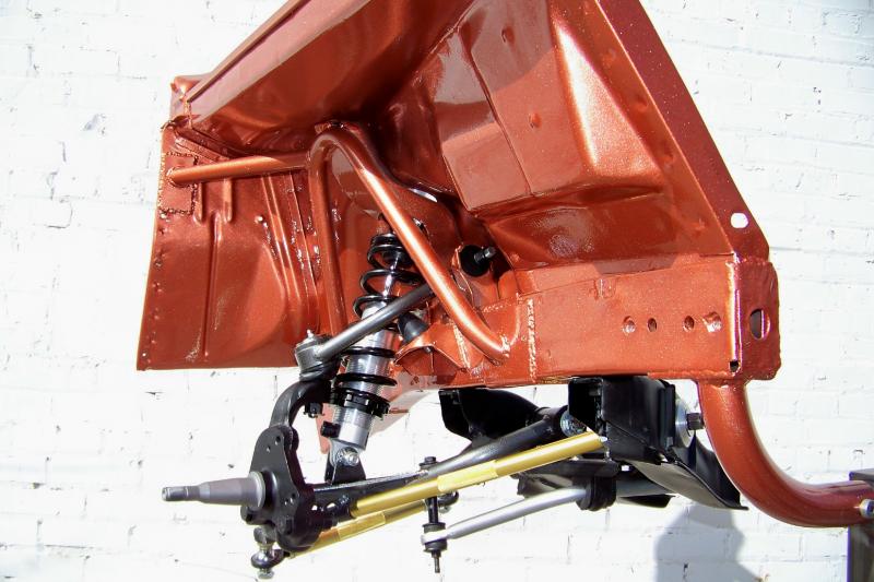

Been thinking about going the same route with the valiant (coilovers). Talked to the fabricator and he is positive he can make a strong/clean coilover setup. It will be a solid suspension setup and will also open up much needed room for long tube headers. Currently, the torsion bars are making it hard to squeeze them in.
Marvin, I would highly recommend looking at John's stuff. http://www.dillingerchassis.com/
Hard to beat john's (Badart) prices and it is a solid, well thought out design. Bolt it on and enjoy.
