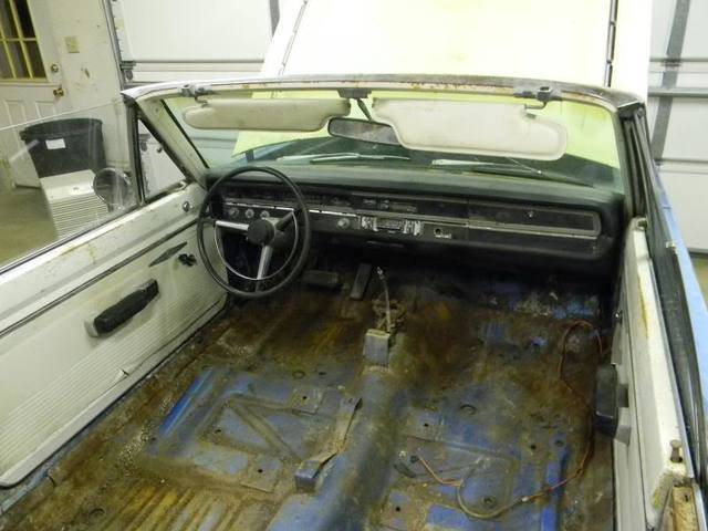

The car is in good shape. The worst part is the interior. The floor looked pretty crusty but I think it's going to clean up OK.

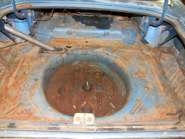

The trunk is in good shape. The spare tire well is solid...it just needs to be cleaned up.

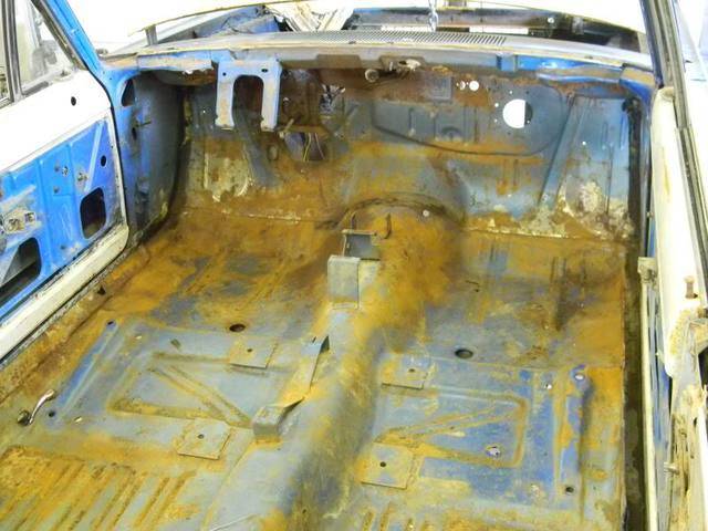

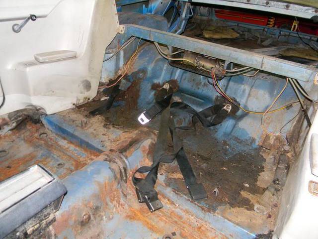

The floor under the back seat was a mess. The convertible pump lines are split and were pumping fluid under the seat where it mixed with all the dirt.
Everything is coming apart on this car very nice. It's fun working on something that isn't from the rust belt.

Interior is all out. I quickly took a wire brush to the floor and vacuumed everything up. It's looking better.

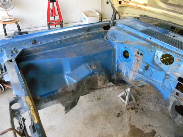

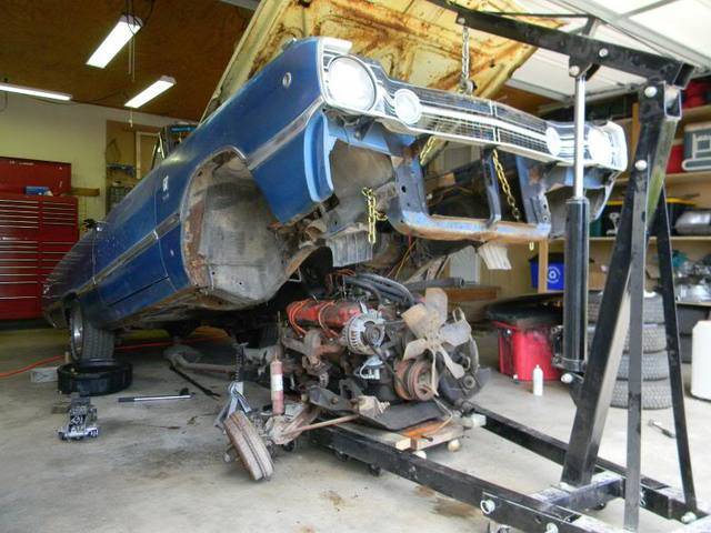

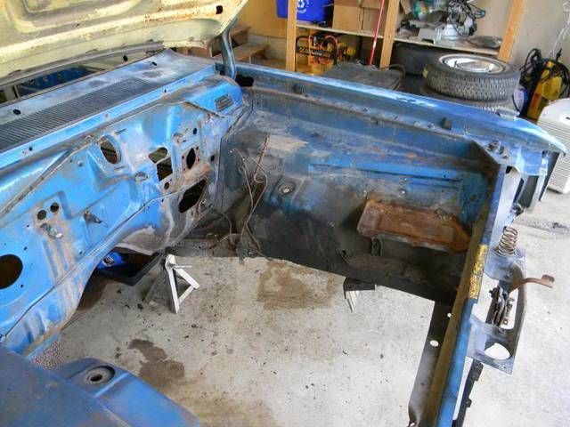

A friend came over yesterday and helped me pull the engine. No more removing/installing engines from above. This works so nice. I'm almost done removing everything from the engine compartment. The grill came off today too. I've got 500 pictures taken so far. There won't be any guessing on how this car goes back together. I wasn't organised when I disassembled my Challenger. All the fasteners were thrown in a big bucket and I didn't take many pics. I spend more time sorting fasteners then actually assembling the car. I'm staying organised with this car. A few extra hours detailing everything NOW, will save me days of headaches later on.

Slowly coming apart. There haven't been any surprises so far. Everything is looking really clean. Here's a good shot of the radiator blackout.

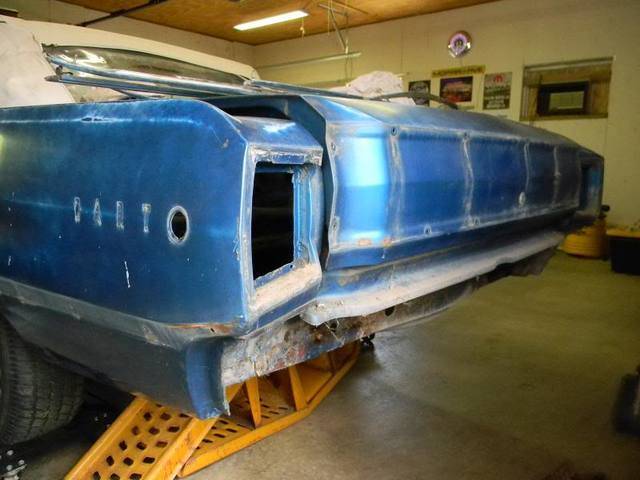

I found some crappy previous bodywork that was done to the car...probably from the late 70s or early 80's. We'll see how bad it is when the car is stripped. It almost looks like someone brushed a guardrail or something. There are holes drilled in the PS quarter and door as well as some is the DS door. There's filler sticking out of all the holes.

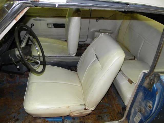

This is kind of backwards but I'm taking the seats to the upholstery shop tomorrow. The seats are taking up space in the garage and I don't want those nasty things in my house. I removed the seat tracks tonight. They look pretty rough. A long soak in a rust remover should clean them up. I'm missing the pieces under the seats that connect the track reliece levers. Was there just a wire connecting them or was it a spring of some kind?
The springs in the seat backs are very rusty. Hopefully they will be usable. Once the frames are stripped, I'll take them in to be blasted and powder coated. Then they will go back to the upholstery shop.
The front seats still have the chrome inserts in the seat backs. There isn't one on the rear seat...should there be?
Got mine from P&G classics, here they are. What chrome inserts are you talking about the emblems in the top middle of seat? If so yes there should be one in the center of the rear seat, I see them for sale once in a while on ebay, or you may find them on here also

I'm still slowly taking it apart. I got the tail lights and rear bumper removed yesterday. I've only broken one bolt so far. That one was while removing the wheel well splash shields. Right when I was about to stop and back it up, it snapped. The only big things I have left to remove are the rear axle and convertible top.
