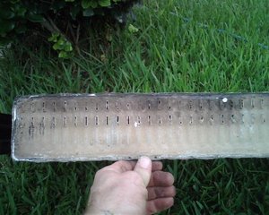

The picture is what I found when the top tank was removed.....
out of the 32 tubes shown, only 10 are fully open and some are completely plugged.... AND this radiator cools the car just fine while in traffic!!! ( I had this one in the car before I switched back to the 22" )
I haven't snapped a pic of the cleaned cores yet but some were actually plugged with solder and not from the unsoldering process. ports 7,8,9 from the left on the bottom.

Well the radiator went back together and does not leak so far, I had to rig up something to pressure test it but could only put about 6psi into it with a bicycle pump before my rig started leaking. So I'm a go for this weekend for the one in my car. here is what it looked like after I cleaned the cores. (I did straighten the openings before putting it back together) The solder I used was the lead free plumper's solder from home depot (430* melting temp)

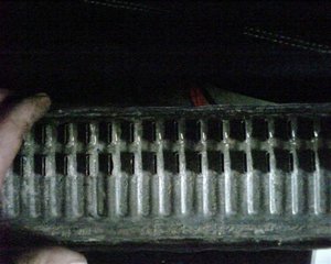

Well, I pulled the 22" radiator on Fri night to see how bad it was, and it was worse than the 19 pictured at the begining of this thread...
Sorry the pics are so crappy (Phone camera),.... see explination in my last post...

I know it's not brand new but it gives me some time to save up for the $400 griffin radiator.. :(
