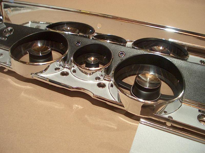

I have been restoring these for a while now and only charge 375 for the dash, lenses, and glove box panel. I have done a couple for members on here before and have not had any complaints.
