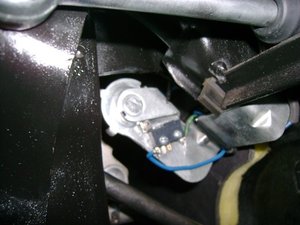

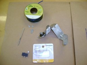

Parts to repair clutch safety switch and install by-pass switch:
Radio Shack
- Micro switch $3.00
- Toggle Switch: $3.00

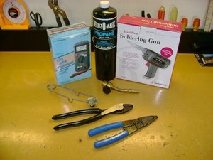

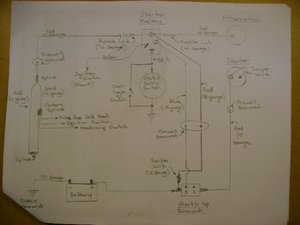

Now for the pictures. The first set will cover most of the misc. parts needed to do this job as well as my own schematic that documents all three upgrades:
Here's my hand drawn schematic that shows all the upgrades that I made:
The 1973 Manual actually has a very detailed wiring schematic for the Dart.

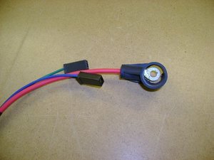

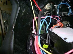

- 10 gauge red wire with fusible link provides 12 volts to dash area.
- 8 gauge red wire connects to battery 12 volts in trunk
- 14 gauge blue wire goes to the trunk to operate the "start'm up" solenoid.
- 16 gauge green wire is the stock clutch safety switch ground wire.

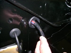

This shows how I used the stock grommet for the manual washers to route the wires from the starter relay and starter into the firewall. As a point of reference, that's the speedometer cable on the left.

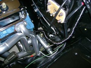

Starter wire route. Notice the use of the Thermo Tec heat shield and stock bracket to hold the starter cable.

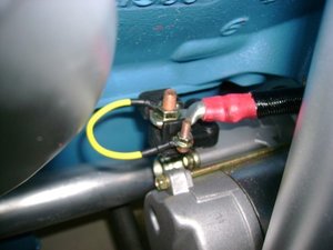

Jumper wire required on the starter when using the "start'm up" solenoid. (See MAD Electrical web site).

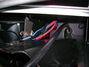

Wire route under the dash. As a point of reference, that's the speedometer cable on the right.

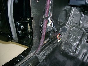

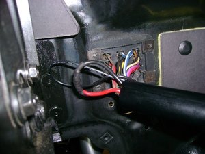

Cable route by drivers side kick panel:

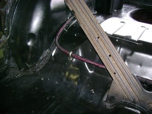

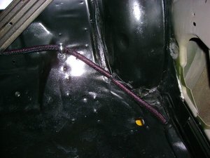

Cable route into rear seat area:

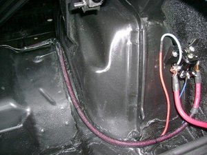

Cable route into trunk:

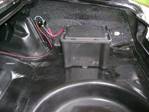

Battery box. Notice hole on front right of box, that's for the vent hose that I'm going to run through the trunk floors existing grommet hole.

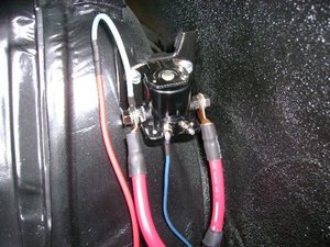

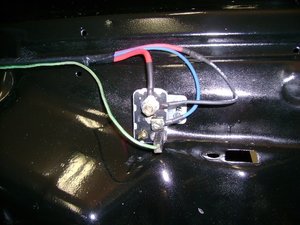

"Start'm up" solenoid wiring. Notice 14 gauge blue wire and 8 gauge red wire ( with fusible link) from the starter relay connect here to the solenoid. The 1/0 gauge wire on the left goes to the battery and the one on the right goes to the starter.

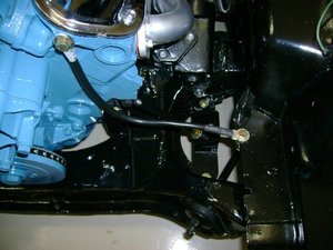

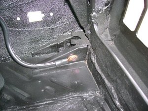

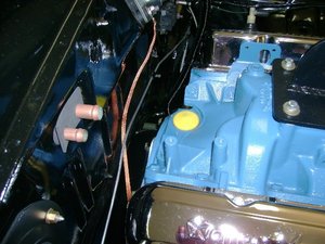

Grounding...

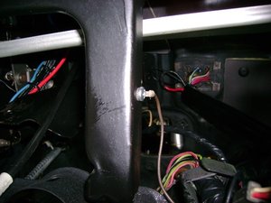

Good solid ground connection for under dash area.

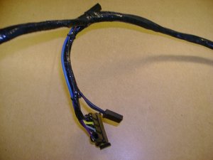

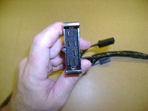

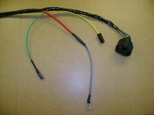

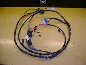

New wire harness with modification for alternator wire to by-pass bulk head connector:
Notice that the alternator wires going into and out of the bulkhead connector are missing...the new 10 gauge wire is hidden in the harness.

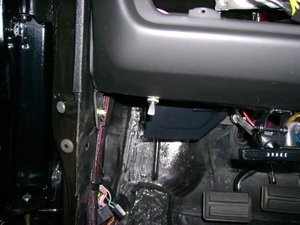

This picture was taken looking into the dash cluster area and shows how I spliced the two original ammeter wires into the new red 10 gauge wire. You can also see the back of the toggle switch that by-passes the clutch safety switch and the routing for the cables to the trunk.

1. Starter relay with battery in trunk provides current/power to the larger battery cable only while cranking.

3. Clutch safety switch and by-pass are my own deal. I wanted both in the car so on the odd chance someone else is starting my car they will need to depress the clutch first. But normal operating will be with this bypassed so I can start car in neutral because it's easier on the thrust bearing.
