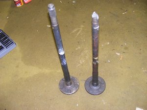

Anything over 400hp with a 8 1/4 you,ll be taking your chances/life at the track.Trust me,I had the axel and wheel pass me.Lucky to not ruin my 1/4 panel.Go 8 3/4/Dana.
I've read that the 81/4 was used in some performance applications but "performance" back in those days probably meant "mild" performance. I'm going to go ahead and build the 8 3/4 and have piece of mind that I'm safe. Thanks for the pics pettybludart and everyone's information.

I'm sure that there are but I'd hate to have my axles looking like the guy's above. I'd rather spend little more money to build an 8 3/4 now rather than spend the money to build the 8 1/4 and break it and have to spend more money to build a 8 3/4 later.
