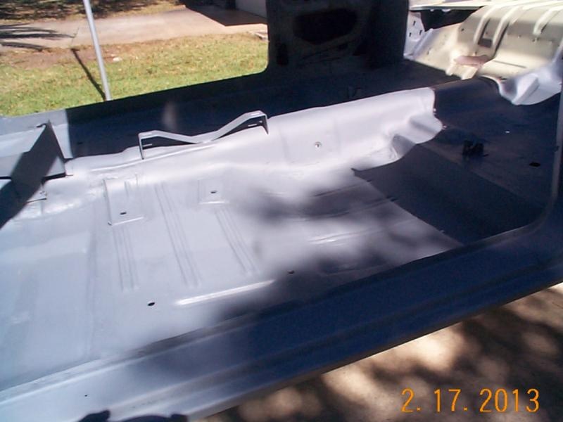

Last week I was able to get some work done on the car, I sprayed epoxy primer on the interior floors, engine bay and uderside. Now today i;m going to do a little patch work (bondo/fibral) to the underside welds of the floor pan patches since i don't really care for the look of the seam sealer on the underside. Any recommendations on the work would be appreciated. Thanks, Jim
