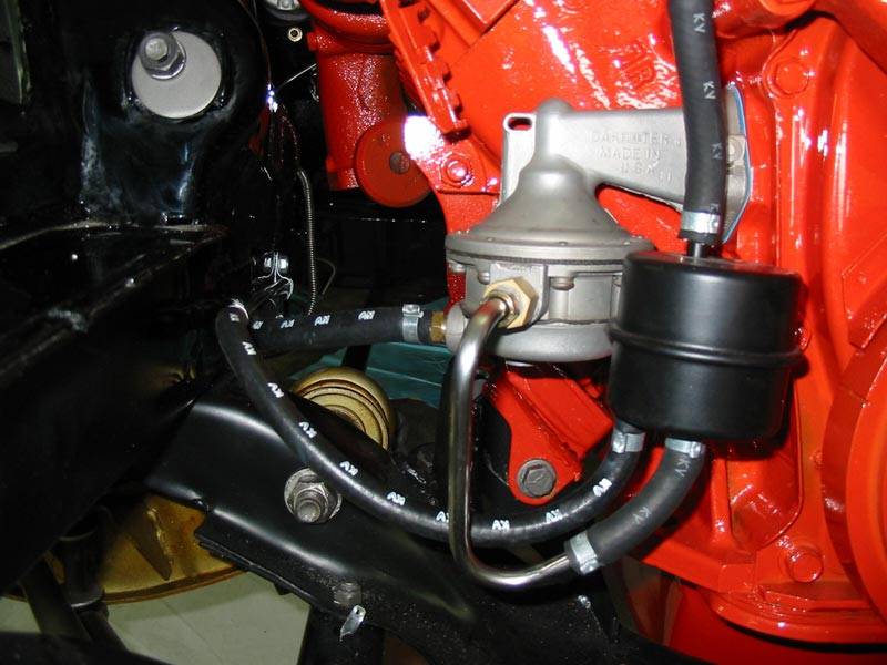

i just added a return line to my stock fuel system... thinking i now need a vented gas cap...do the make one or am i wrong in my thinking thanks...
i guess that depends on how you added a return
(which i would find interesting anyway, since im planning on doing the same)
but in short, as long as you did not use an existing vent as the return line, i dont see why you would need to add a vented gas cap

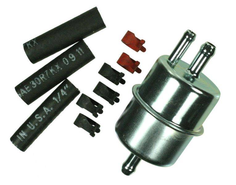

i ran new 1/4 line down the frame and then added these two...i swapped the existing filter up front with three port one witch has a .006 orfice in the small port, and keeping the port on top...

i do have that tube that runs along the filler neck so you are correct no need for a vented cap... thanks...

i thought i read somewhere these filters need to be installed a certain way, and having looked at the drawings, that makes sense
the person you really want to talk to is @RustyRatRod
The WIX filter is not a vapor separator, so it does not matter which way you point anything. It is a liquid fuel filter.
so iam going the wrong way? to help with vapor lock...it does have the .006 orifice.... i was told to use it to help with vapor lock... ideas? do i need a vapor separator like the ones for the hemi and the 440 in 1968
No, you are fine. The orifice though is not .006, but .060. Big difference.
The purpose of the return system is to lower fuel temperatures and THAT is what kills vapor lock.

A vapor separator is exactly what it says. Fuel vapor is returned to the tank through one outlet while liquid fuel is fed to the engine with the other.

since the wix filter i have installed is not a vapor separator, what is it? is the real vapor separator the better choice thanks for all the info
Post 14 says "NO YOU ARE FINE" That means you are going the RIGHT DIRECTION. The WIX filter is just THAT. A LIQUID FUEL FILTER. It is not a vapor separator. With what you are doing, the fuel filter is RIGHT.
