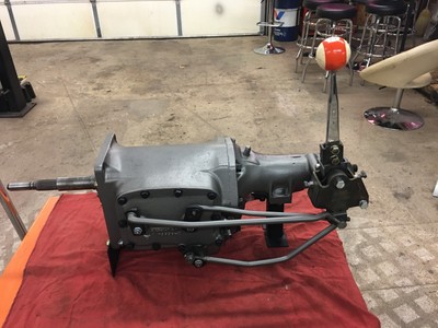

this is not the exact 4spd you would want-- it's the early type with a ball & trunion type output and not the slip yoke, and while it would work, it's not ideal. but the price is about what i would expect to pay for a later (67+) complete A body 4spd with a shifter.

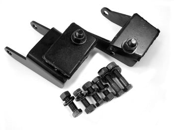

You can also use the TransDapt engine brackets and save a few bucks over the Schumachers, I have used them in the past with good success. Some have had issues with them, but some have had issues with the Schumachers too. Your call.

Schumacher mounts. I would avoid the transdap, lazy copy, they did not even machine the drivers side biscuit. Only reason I used it is because the Schumacher company had not been saved yet when I bought my stuff. Schumacher are such amazing stand up people he sent me HIS instruction sheet for the COPY product! Amazing people.
I installed my engine twice, first stabbed both together, and could never get it right in the center. Engine had a noise so pulled just engine and re installed. Went in perfectly. The biscuits are sideways on a big block swap and acted like sliders which allowed perfect placement and a slam 'er in approach. I did not need to use the shims at all.

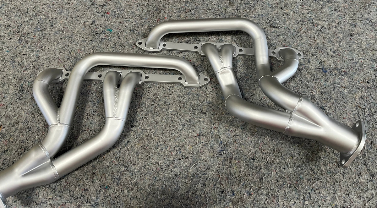

Schumacher Tri Y headers. TTI are a better option, Pro Parts are too if all out performance is the goal. Not a fan of the TTI and how tight it all sounds, and pro parts means cutting stuff up. Schumacher are easy to install, very easy to change plugs in car, etc.
Big block trans, ran it last summer with 727, in process of A833 swap. Going with hydraulic to avoid clearance issues etc. Swapping from auto to 4 speed is the identical process whether running small block or big block, with the exception of what bell you need
