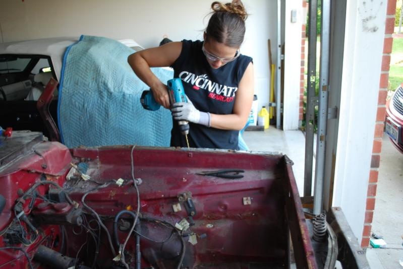

Attached are two photos of my oldest daughter helping me a on the Barracuda. She was grinding the the heads off some bolts so we could remove the inner fender splash shields and removing some popriveted on sheet metal repairs from the inner fenders.
