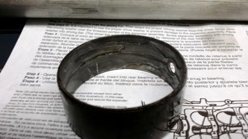

drove them out, 15 minute job. no problem. shop kids did it. now to get cleaning the block~ bearings were wiped for sure.
It is a slick deal. I did mine a couple of days ago, slick and easy. I hope going in is as easy.
Yeah, Mine weren't too good either, lol.
