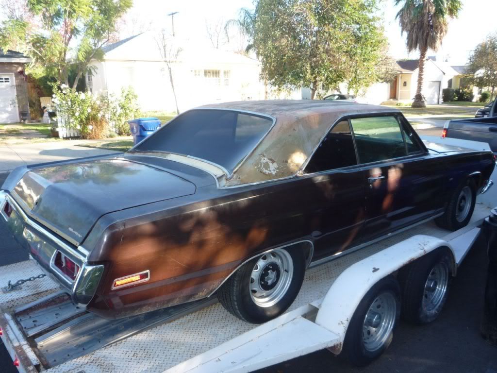

Here it is being delivered. The seller drove it out from Vegas yesterday, guess there are a few good folks on eBay after all; but we are car-guys, we have to take care of each other!
So we inspected the car together, found a few more body spots (dents,rust) than were apparent in the auction pics and a few rust spots that were worse than represented in our dialogs; so he adjusted the price accordingly - stand up guy.

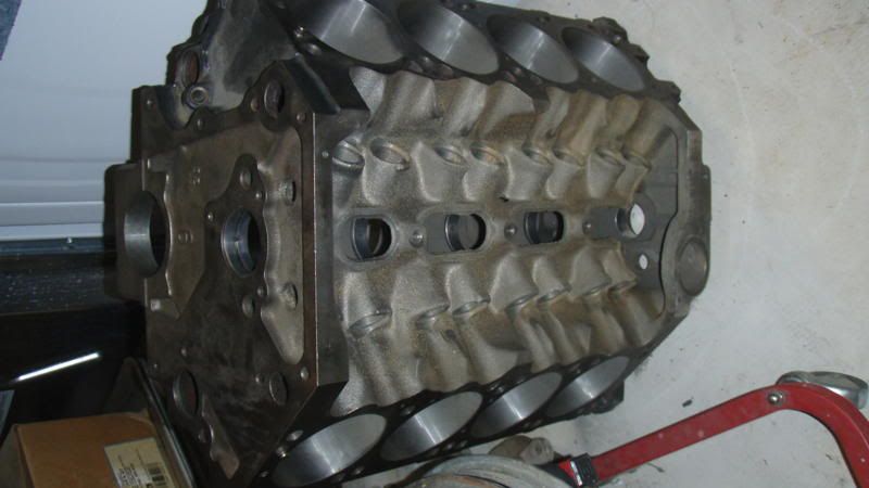

-a '99 360 magnum roller block, hot tanked and line bored .030 over

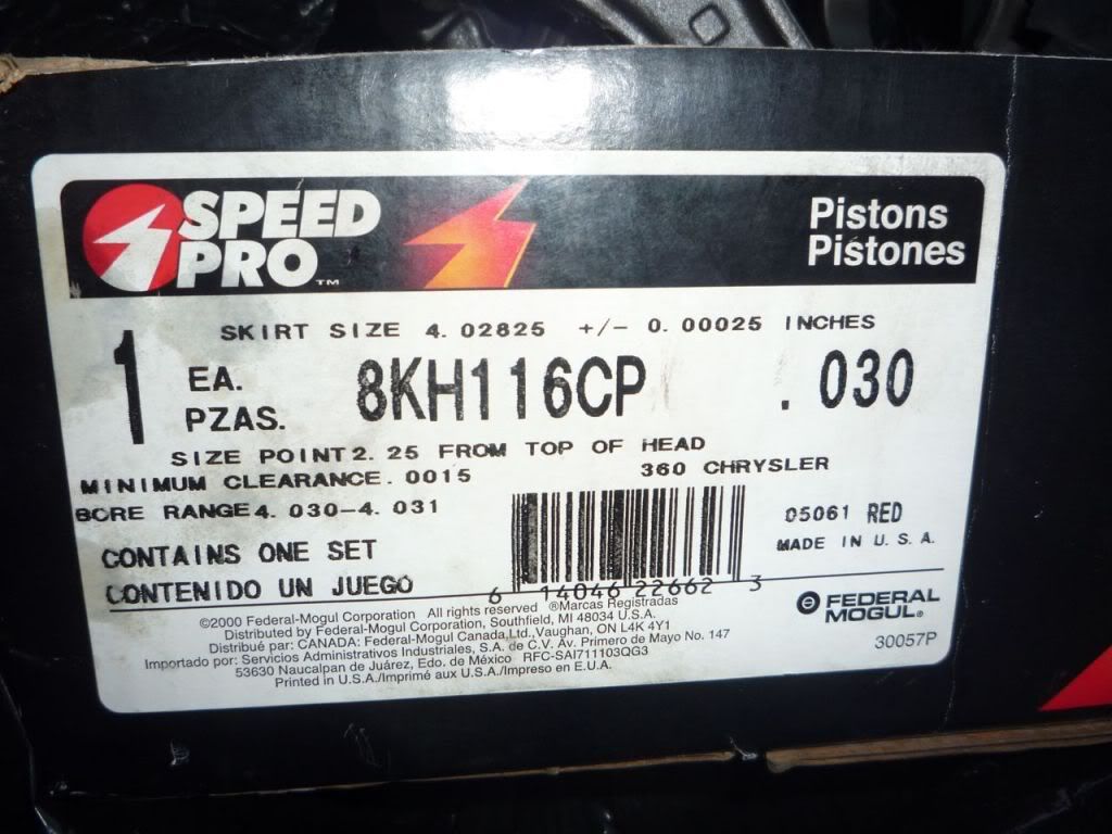

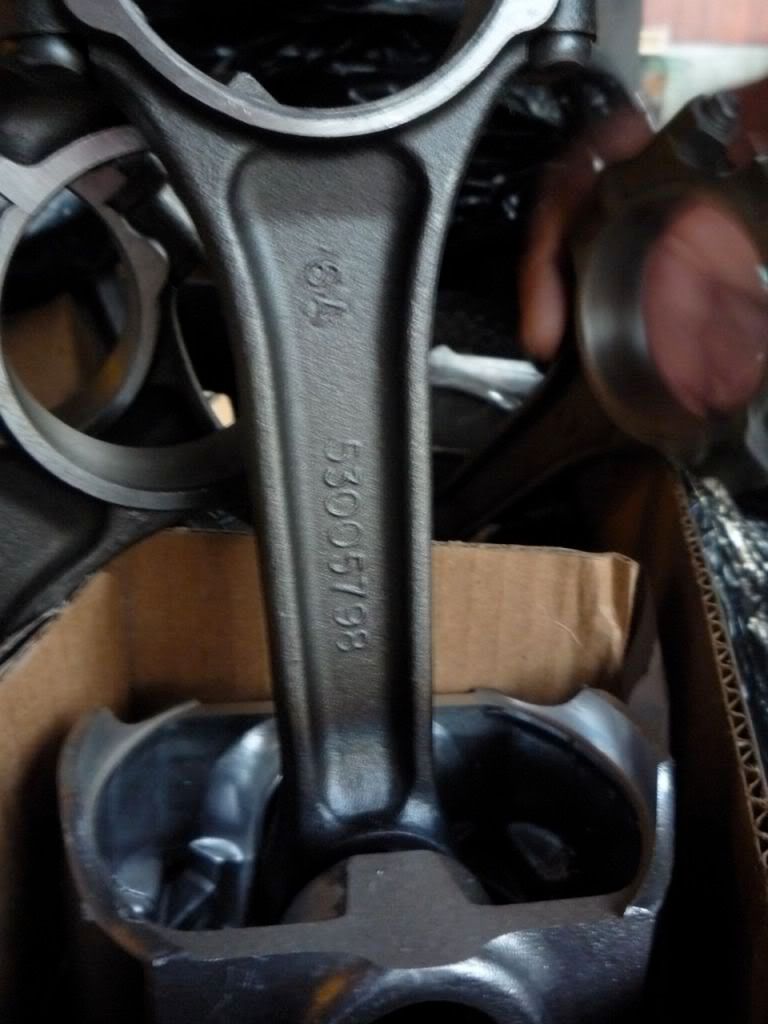

-SP Hyper .030 over pistons mounted to rods and balanced

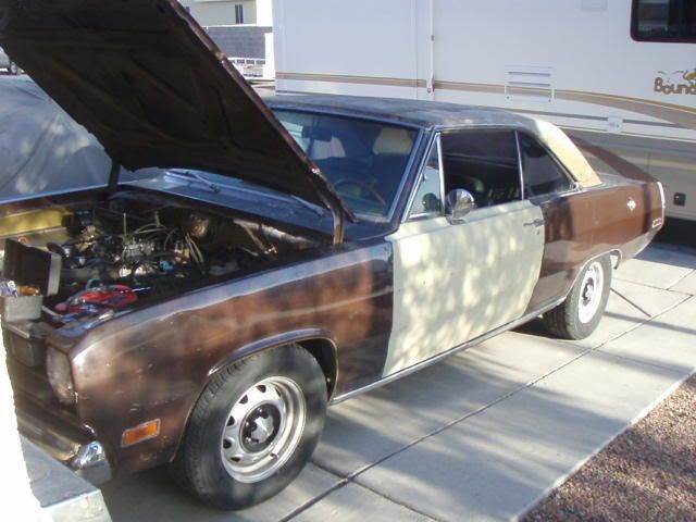

Back to the Scamp. The car has a few nice parts on it already too:
-running 318 in it, probably the original one, but leaking oil and who knows what else...
-new Optima battery
-an older Edelbrock Performer intake
-Carter 4-bbl
-electric fuel pump seller installed himself (super quiet actually)
-340 exhaust manifolds
-new 2.5" x-pipe exhaust to walker turbos and dual rear layton SS tips, it sounds good too
-cam unknown, suspected Erson by the seller but who knows...
-904 trans, supposedly "built" to take some abuse by the seller's dad (old mopar trans guy)
-magneto distributor of unknown origin, but at least no points
-power steering which feels great!
-Police disc brakes swap up front on 4-1/2 bolt pattern rotors
-14 x 7 rally rims and caps with 4-1/2 bolt pattern and caps
-new Kumho tires all around
-8.25" (suspected) rear end with unknown gears, seller things they are 355s, will find out today!

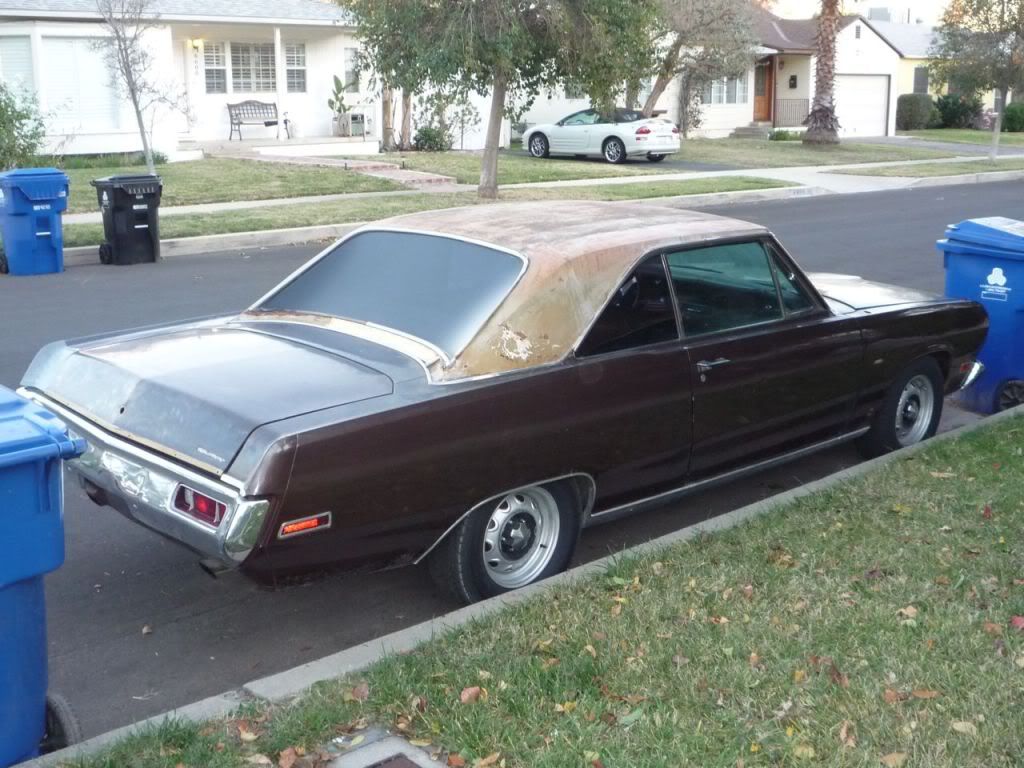

The interior and body need a lot of work, which I expected honestly. All in all it should be a fun project car and I have yet to decide what I want to do with it. I would really like to tackle the oil leak first, looks like the rear main seal, but I will need to get it registered first, I will try to do that today so I can park it on the street.
