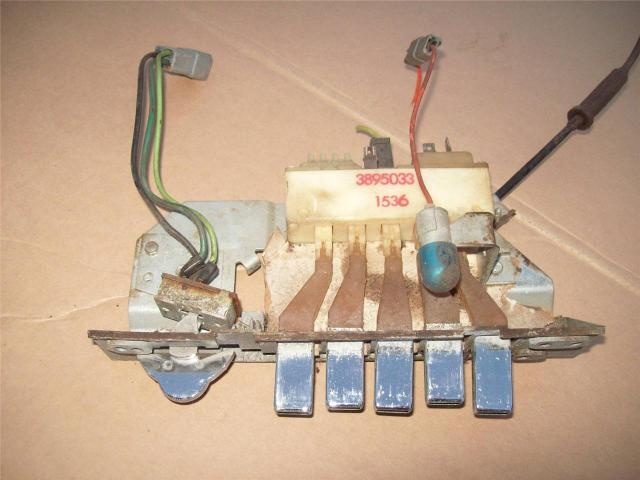

Well out comes the Fluke. I wonder if the push button controls are the culprit? Maybe when I'm pushing off, the electrical contacts aren't being opened inside the plastic controller.
Not a picture of mine, just for illustrative purposes.
attachment.php
attachment.php
A test light at the compressor with the switch off will tell you, but we already know what that will show.
At the switch is a good call though.
Those switches get pretty beat up inside and I have had to repair a couple already that wouldn't move at all.
They came out nice and smooth after.
There is a sticky at the top of the electrical section on rebuilding these controls. BTW, the right-most, large pair of electrical contacts in the back are for the blower and should be on in any position except off. The center connections in the back are for the AC I do believe. Yeah, these get beat up, the grease gets dry and the internal sliders don't move, and the contacts get bad.
