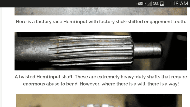

My advice is that if you plan to beat it to hell with sticky tires, you'll be sorry if you stay with the 23 spline transmission.
Think about it, the factory wouldn't have stuck a much more expensive transmission and rear ends in the 440 and better 4 speed cars along with the Dana 60.
It wasn't about hype and promotions, it was to cover their *** on warranties.
The 440 cars were an honest 350 + H.P. and the Hemi cars were about 450 to 475 real H.P. but, the torque is what the extra strength was needed for.

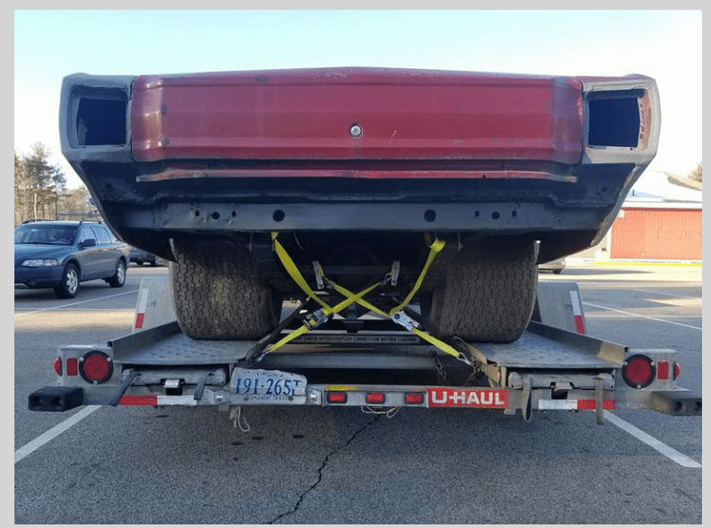

My bad, I was judging from my prospective witch is tubs are not "street car".
Well, to be fair, I wouldn't have tubbed it out myself. I would have put some wider wheels with appropriate backspacing on for some "wider" tires. But these suckers look good....and I don't think traction will be a problem...turning maybe, but not traction! lol
Was that a serious question ?
Yup. This is all new to me. I know the difference between LS/Open/Posi differentials. "Spool" is new to me, unless you're talking about turbos, lol
spool = no open, no sure grip just two gears and two axels. Direct drive to both axels at all times.
