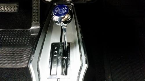

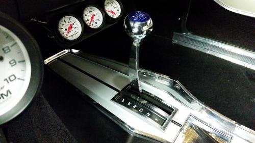

I waiting for my Hurst ProMatic 2 to arrive later today, bought it for $99 on Ebay. 65 Dart console is shorter then later A-body consoles but we'll make it work. I like the look in MileHighDart with Hurst.
Went with B&M Quicksilver and Speed Dawg shifter knob. Also made up an aluminum sleeve to cover wire from shifter knob.

Hurst quarter stick, similar to the B&M prostick... Auto-plate, I cut the hole bigger with a dremel, and removed the factory auto-indicator. The chrome trim around the shifter and the top-plate are 3m vinyl all stick down... My wife made the boot...

Also one more, all done now everything seems to work fine. 65 Dart GT factory console :cheers:
