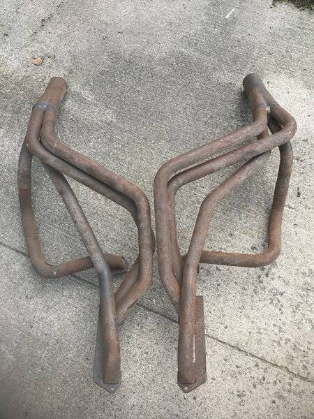

I have a set of race headers but I’m up here in Minnesota....not sure the brand, been in a barn for 40+ years hanging on the wall but never used

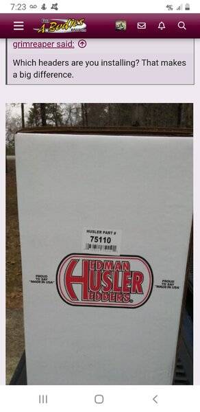

my brother used the 63-66 A body TTI step headers on his 66 Dart. 408 stroker
Tight fit, but they fit. Figure on a weekend, mixed with cussing and swearing
