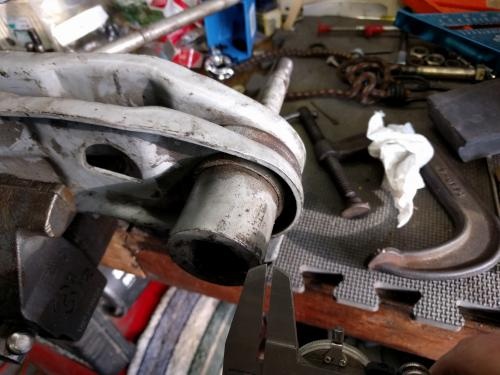

The LCA is spread open and the cylinder that holds the torsion bar has a lot of play. Two rough measurements show 0.100" on the torsion bar side and 0.125" on the post side. I guess that's why it has gotten worse over time. Back in 2002 I had not yet heard about the reinforcement plate upgrade. It's sounds like a good idea now, but both of these are shot. OK, next question: Who makes the best aftermarket LCA?

BTW, the reinforcement plate goes on the bottom of the LCA and is to keep the two sides from opening apart. On the second pic that arm doesn't look too spread apart.

Im not seeing anything in your picture that appears abnormal. Except maybe that lower control arm bushing. Maybe we need better pictures
You can fix the slop in those arms. They likely left the factory that way.

Jim's right on, and that video is a great help if you're going to reinforce the LCA's. Only thing I would say about that though is that they very well might have left the factory like that, which means they might not be the cause of your recent camber issue. I would be sure to really check the LCA pivot mounts in the K frame, and pull those LCA pivots out of the LCA bushings to check the bushings as well.
For the LCA's you really only need the reinforcing plates, which are pretty cheap from PST if you don't feel like making a set (also not that hard). In addition to the reinforcing plates I add a strap to the end of the LCA to keep if from spreading, even with the reinforcing plates some spread is possible (although it takes a lot more force). This is the strap I add to mine, you just have to make sure that you don't make the LCA too tight so that the lever arm doesn't move freely, and of course you want to locate the strap so it doesn't interfere with the travel of the lever arm.
