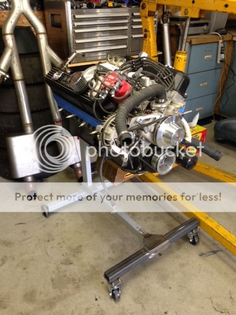

picked up a cheap engine stand on craigslist. paid $20 for it. it started as a 3 legger. I think they are very unstable that way so i built a new leg for the front end and welded it on with 1/4" gussets. I feel alot better about it now.

harbor freight would have been my 2nd choice if i hadnt found a stand on cragslist. I did ditch all the hardware that this stand came with. went to local hardware store and got all grade 8 fine thread bolts for the mounting plate and grade 8 bolts for going into the block. just little piece of mind.
Also take a good look at the bead between the tube and the engine plate. I've got a yellow one that doesn't look very strong
I replace the universal head with a dedicated H style head that bolts directly to the block.
