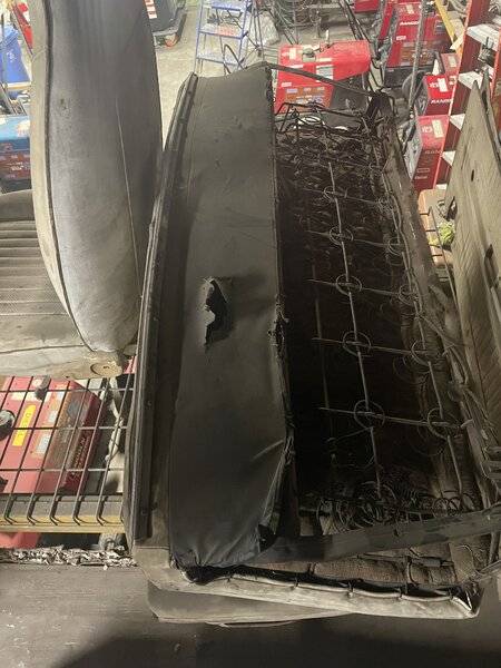

Here is a picture from the truck of some blacked out springs, I cut up and painted the box my carpet came in.
I was going to use the cardboard as a template. but there is no good way to seal up against the floor probably
why the factory did nothing. This was cheap and easy, I went with it. Here is a pic of the console strip and the old carpet.
