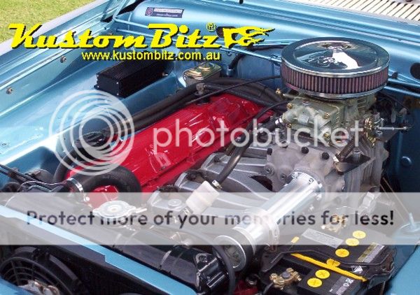

I also like the dual carb look. But the look I like even better is the "blower-with-Hilborn-scoop-through-the-hood" look. That is what I am starting on right now. Got my blower, engine, pistons and oversized valves. Just need to finish my car's interior and paint and then it will be time to build the coolest mill in town!
http://s674.photobucket.com/user/FredVolz/media/Supercharged-Valiant-Slant-six-AussieSpeed.jpg.htmlhttp://i674.photobucket.com/albums/vv108/FredVolz/Supercharged-Valiant-Slant-six-AussieSpeed.jpg
