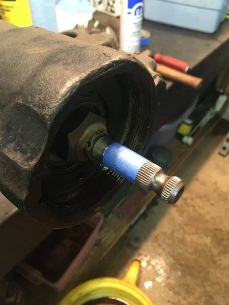

Did I wreck the steering shaft changing seal

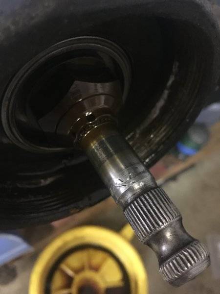

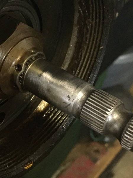

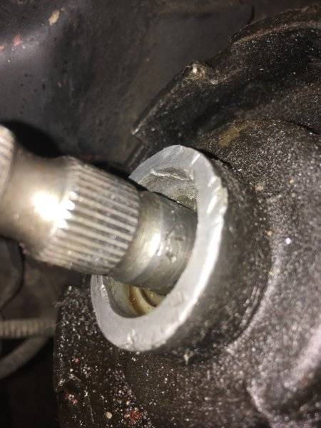

the screw trick didn’t work. That’s when my blood pressure spiked

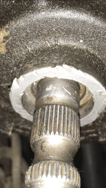

Why didnt you just spin the nut ring off, remove the aluminum cover, and tap the seal out from behind? Yes the input shaft Is fucked
Looks like the shaft is chewed up where the seal will ride. If that's the case, it's gonna leak from there. The old seal probably did a better job than the new one will do riding on that chewed up shaft.
If the spline is slightly smaller than the area where seal runs, use a speedy sleeve.
The driver that comes with it will be too short.you will need a pipe that fits exactly like the driver.
Will need to clean up the shaft a little.
Well, if you are stuck for getting a new steering box, chuck the housing up in a vise, take the cover off to gain access to the shaft. Get some "quality emery cloth" 220 to 320 grit and buff the shaft to remove the jagged edges of the damage "only." Clean the shaft completely with MEK or acetone. Mix up a small amount of JB weld (not JB quick) and work the mixture into the damaged area "only", making sure the mixture you apply is (reasonably)piled up above the damage. Using scotch tape (preferably) or masking tape, wrap the shaft (tightly) with a layer of tape. After the mixture is cured (I would wait 24 hours) remove the tape. (use some goo-gone to remove the tape residue) Using the emery cloth, buff the mixture to a point that only the filled damage can be seen. Smooth the jagged edges of the seal land on the cover, install a new seal, with a little Permatex on the outer edge of the seal. Coat the shaft with a little silicone, or Vaseline and install the cover. This could get you going again.

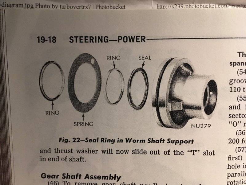

pretty sure I put the ring on the wrong side of the spring. Unless the od of the ring fits through the id of the spring.
