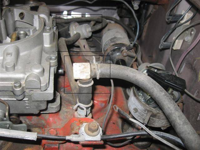

dibbons Well-Known Member Joined Nov 6, 2009 Messages 5,744 Reaction score 3,829 Location La Paz, B.C.S., Mexico Sep 15, 2021 #1 Maybe the little separate vacuum tank (painted black on driver's inner fender in photo) takes the place of the need for a check valve. Anyone know for sure? Thank you.
65 Dartman 1 of None 65 Dart Sedan Delivery FABO Gold Member Joined Sep 24, 2006 Messages 13,752 Reaction score 4,599 Location Strasburg, VA Sep 15, 2021 #2 @65dartcharger
Professor Fate Push the button, Max... Joined Jan 13, 2020 Messages 6,700 Reaction score 11,767 Location Wisconsin Sep 15, 2021 #3 Inline check valve- 90* off the intake vacuum fitting. Pic stolen from old thread.
