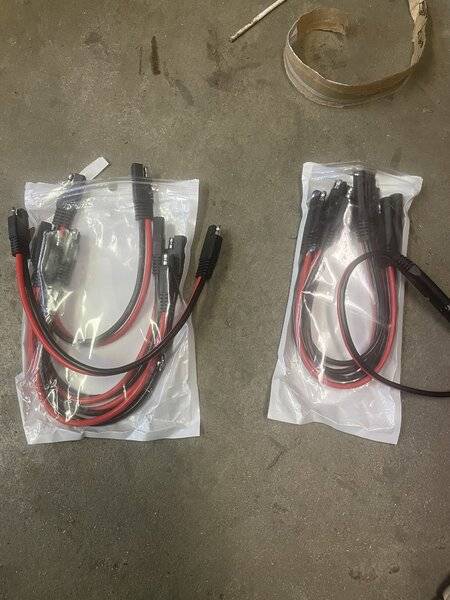

I took a little extra time on this job and ordered more electrical disconnects in 10 and 12 gauge wire so as I do projects if it doesn’t have a quick disconnect in-line put one in. I hate screwing around trying to unhook stuff like alternators and radiators when you can unplug things in seconds.
