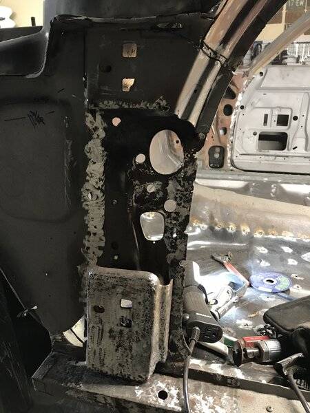

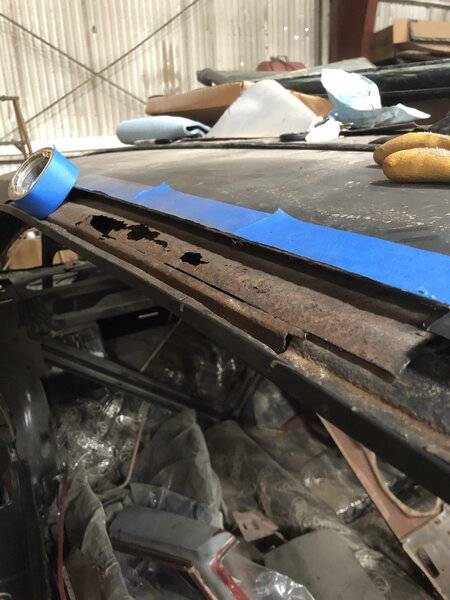

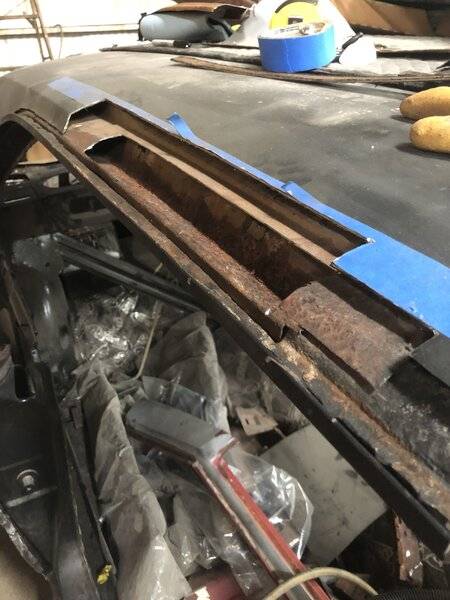

I've done floor pans, trunk pan, drops, inner fenders and straight line quarter panels.etc. Where it's easier to get away with some beat to fit, paint to match. This is my first time doing something more difficult like rust r&r in an a-pillar. I'm trying to avoid pulling the dash and glass. Have removed the rust back to good metal.
My first question is will a copper sheet between the dash and a-pillar protect me from welding the a-pillar to the dash? LOL

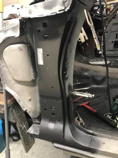

I'm thinking slow and easy, Keep everything nice and cool. Do a spot weld, let it cool really well. Do another. Inside patch first, work my way out. Weld thru primer will be used for sure. Here's my donor.

Those a pillars are layered as you know.so at our shop we would start with that inside piece by the dash.just jam a piece of scrap metal behind it and weld it from the inside so the weld would be covered when you attach the outer piece. Once you got the inner pieces looking factory primer the inside cavity and lay the outer piece on top. Trace it with a sharply where you want it and then trim the car to fit the ppiece.it's easier then shaping the piece and shooting it across the room lol.The tighter the fit the easier it will weld. If using a tig get some .020 wire .it wont shoot holes in that thin metal .put a tack every 1/2inxh or so, and clean it well with a wire brush often as you do it. The only other advice I have is to keep an eye on the urethane around the windshield. It doesn't take much heat to make that stuff melt and drip where you dont want it. Oh ya put some seal seal around it after so it doesn't ever leak again

Awesome! Thanks for the help! I'm using a mig, I'm assuming you recommend the .020 wire for that?
You are doing great!!! I didn’t have to work around my dash but there are good comments here. Keep a spray bottle near and/or compressed air to cool
JMO- If it's your first attempt at something like this, you may be Flirtin' with Disaster (forgive the Molly Hatchett reference). I would at the very least pull the dash pad. It's a pain in the patoot, but it could save you days of banging your head on concrete walls while spewing out four letter words you didn't even realize you knew... The worst has a tendency of happening when you try to take the easy way out. Dressing/finishing the weld on the interior will also be almost impossible, but that area will be covered by the A pillar trim. Welding spatter tends to go places you never planned, and have effects you didn't foresee. I'm sure BP has it down to a science, he's a pro- but I wouldn't trust myself on this, and it's not my first time at the dance. Even the windshield, no matter how well you think you have it protected, if you get even a little spatter that finds it's way through, you'll be staring at it every time you get behind the wheel. Re-commence head banging. I once was welding (carefully, so I thought) a c-pillar seam and blew out a rear window- wasn't even near it... probably a freak occurrence, but why tempt fate?

Thanks for your comments and I don't mind the Hatchet reference at all. You know, Florida boy and all. You have touched on some of my major concerns. The dash pad is definitely coming out at the very least. It's trashed and has a plastic cover anyway, but why chance it? Pulling the glass and the dash is a whole 'nother story. Obviously, it is definitely the best way. And I have advised the car's owner, my son, about it. He thinks we can get enough cardboard and welding blanket around the rest to protect it. Hmmmmm........
